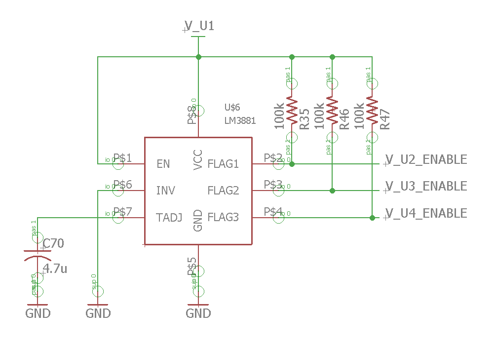

I'd like to use the LM3881 to power 3 devices (U2, U3, U4) sequentially when a certain device (U1) is powered. However, once U1 loses its power, I'd like the other ICs to be shut down at once instead of sequentially. I thought about the following circuit:
That way, the pull-ups would be pulled to zero once U1 loses its power. Is this the way to do it, or is there a better way. Alternatively, is there another chip than the LM3881 that only does the power-up sequencing and powers down all devices at once?
Thank you,
