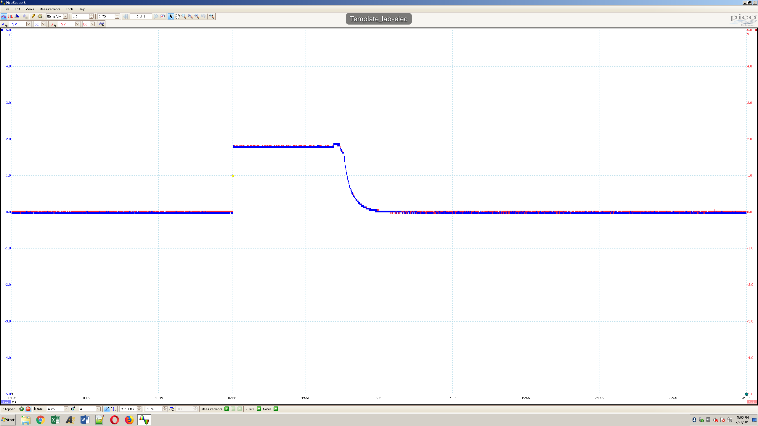

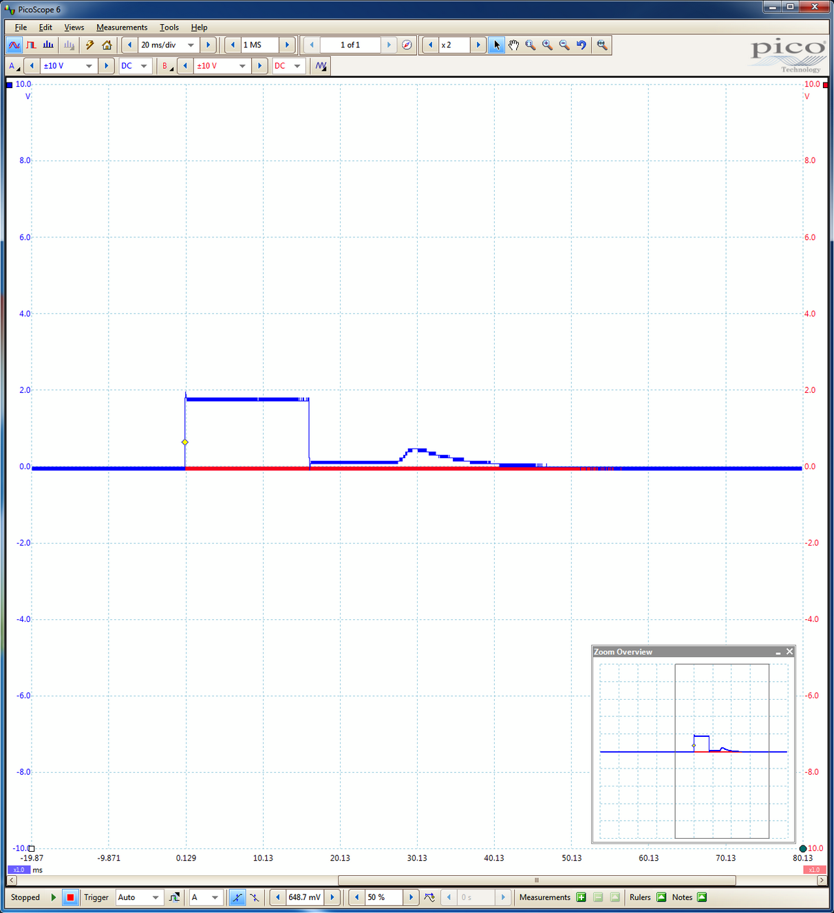

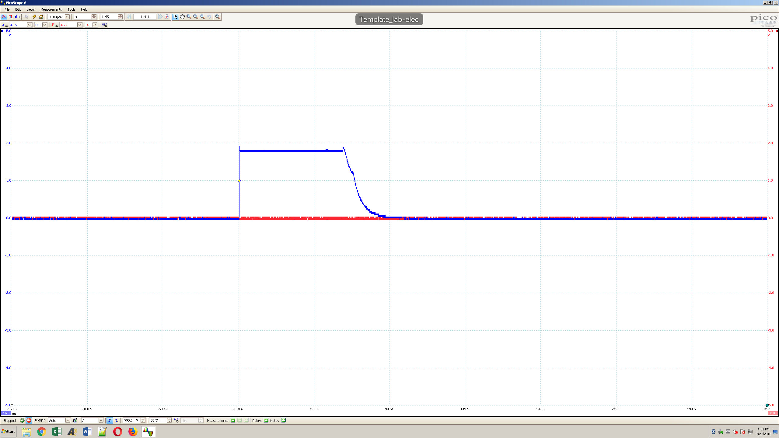

My problems are:
  • The VDCD3 doesn't work (red line: VDCD3, blue line: LDO1) :
  • The wake up unsuccessful start (red line: NC, blue line: WAKE_UP) .
  • LDO1, PWR_EN and WAKEUP are enabled at the same time, but according to the Power-Up Sequence for TPS65217C, these lines shouldn't be enabled at the same time.

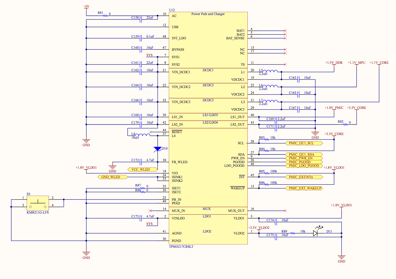

My PMIC Schematic is:
Do you have any suggestion to fix my issue?
  • RSET1 and RSET2 are not the correct value in your schematic. ISET1, ISET2 cannot be shorted directly to GND. Refer to the datasheet for optional RSET1/2 values.
    Based on the timing you have shared, it looks like one of the rails powers on and fails to get to regulation. This causes a fault and the PMIC shuts down.
    You will need to measure the output rails of the PMIC in the order they are sequenced and determine which one fails to reach the desired output voltage: DCDC1, DCDC2, DCDC3, LDO2, LDO3, or LDO4. And then you will need to determine why it is failing: it could be a short to GND or a load that is pulling too much current, for example.
    If the WLED driver is enabled during your sequence, then this is likely the problem because the equation for ILED = 1048*1.24V/RSET. If RSET is 0-Ohms, ILED approaches infinite current and the PMIC will see a fault every time the WLED driver is enabled.
  • You was right, fixe resistances of RSET1 and RSET2 has solved my problem for my second PMIC!
