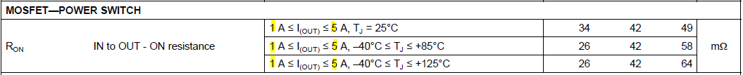

Could you tell me about TPS25942A Ron resistance?
The following contents are described in the data sheet.
Howerver, Ron specification of  "less than 1A" is unknown.
Please tell me the Ron information when the low current condition (0A to 1A range).

  • Hi Yusuke-san,
    The device was characterized between 1A to 5A only, but the Ron would not change with the load current. Ron varies with the device operating temperature as shown in Figure 25.
    Please let me know your target Ron and application use case to suggest.
