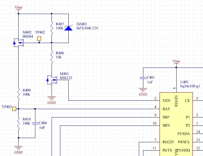

I'm using a BQ34Z100-G1 for monitoring a 1S5P Li-ion battery pack.
Sometimes it happens the SOC value falls to zero, while all other working parameters remain on a correct value (and voltage, for example, is at a value not compatible to SOC=0). When it happens, sometimes after few hours the situation automatically return to correct value, but some other times the SOC remains at 0 and the only way to recover the situation is to disconnect and reconnect the battery (also a reset of BQ34Z100-G1 does not work).
I've read in the post "BQ34z100-g1. SoC Error" the problem can be related to "cell terminate voltage" configuration parameter. I tried to investigate about such a parameter and it could be the cause: increasing such a value, the problem is more frequent, while reducing such a value the problem seems to disappear. Is there any other cause for this SOC=0 issue?
Moreover, how it is possible to force a reset of the SOC estimation algoritm and to let the SOC to restore to the correct value when the SOC=0 situation happens?
Thank you in advance for any support

    Yes the post you referenced is correct: I started from it for investigating about my issue and it seems that the behavior I have is that. But I'm not completely sure, so if you have some other reason to point out for the SOC that fall to zero, please point them out, so I can try to investigate also about them. In fact in my application it sounds strange there are some important voltage dips that can temporary reduce the voltage on BAT pin.
    (I have to say that I'm using a single series cell configuration for my battery pack, but I prefer to activate the VOLSEL bit in Pack configuration register and using an enable MOS on voltage divider network for reducing any leakage from the battery. I don't know if such approach can create some problem on voltage reading on BAT pin.)
    I've selected the proper chemID: my battery model is exactly in the database. So I expect to obtain a good SOC value when I perform a reset also via I2C, accordingly to your explanation. But it doesn't happen. so far I've found two ways for restoring the SOC value after a fall to zero:
    - disconnect and reconnect the battery pack from the BQ34Z100-G1
    - first change (reduce) the "cell terminate voltage" value and, only after that, send a reset command via I2C (i.e. a simple reset without changing the cell terminate voltage doesn't work)
    The problem is that for the end user it is impossible to disconnect and reconnect the battery for restoring the SOC issue, so I have to find a definitive way to fix the problem or to restore any wrong situation only by means of I2C communication.
    Anyway I've selected a proper cell termination voltage value (3000mA, but I can also try to reduce it a little) and the gauge have properly been calibrated.
    So I have no clear ideas for definitively fixing this issue.

  • Hi Matteo,
    For hardware:
    With a single cell source, to eliminate your MOS circuit as a source of failure, try using the internal voltage divider. If the device operates properly with the internal voltage divider (ratio of 5:1) debug should continue with the MOS circuit.
    What is the turn on time for your MOS circuit? If the ADC reading is taken when the device is in the linear region and not saturation, improper voltages may be observed.

    I've found an error in the BQ34Z100-g1 configuration. As I wrote, I'm using a voltage divider with the MOS as enable:
    But in the "pack configuration" register the flag "VOLSEL" is not set!
    Can this mistake create any syncronization issue and so any reading error that can lead to the SOC=0 problem?
    if yes, we've found the culprit and I apologize for the error. If not, I will go ahead by following your suggestions.

  • Hi Matteo,
    If Volsel is not asserted, the device also utilizes the internal divider, which is a 5:1 divider. Please set Volsel = 1 to use only the external divider.
    This appears to be the root cause. Please let me know if any other issues arise!

  • Hi Bryan,
    the additional voltage divider inside the BQ34Z100-G1 should already considered and compensated through the calibration process, right? So it seems strage to be the root cause of the sporadic issue (SOC jumps to 0) I have in my application. In your previous post you mentioned the possibility to have problems due to mismatch between voltage divider MOS and voltage on BAT pin or its reading by the BQ. Can that be influenced by the configuration error (VOLSEL=0 with an external voltage divider with enable MOS)?
    Moreover, just in case I need to restore the proper SOC value without removing the battery, why the reset command via I2C doesn't work? Is there any other way?

  • Hi Bryan,
    sorry for my late answer, but in the meantime here in Italy we were on holidays (August is the holiday month for Italians...) and I tried to make some more time consuming tests (I performed several charge and discharge cycles on several samples) for finding the solution.
    Unfortunately I can't apply any change to the VOLTSEL flag because:
    • if I disable the internal voltage divider, the BAT pin voltage is too high, out of acceptable range)
    • i can't remove the external voltage divider because I have several devices already working on field and I can't apply a recall campaign
    So currently the only way to fix the issue is to reduce the "cell terminate voltage" at the lowest value compatible with battery cells.
