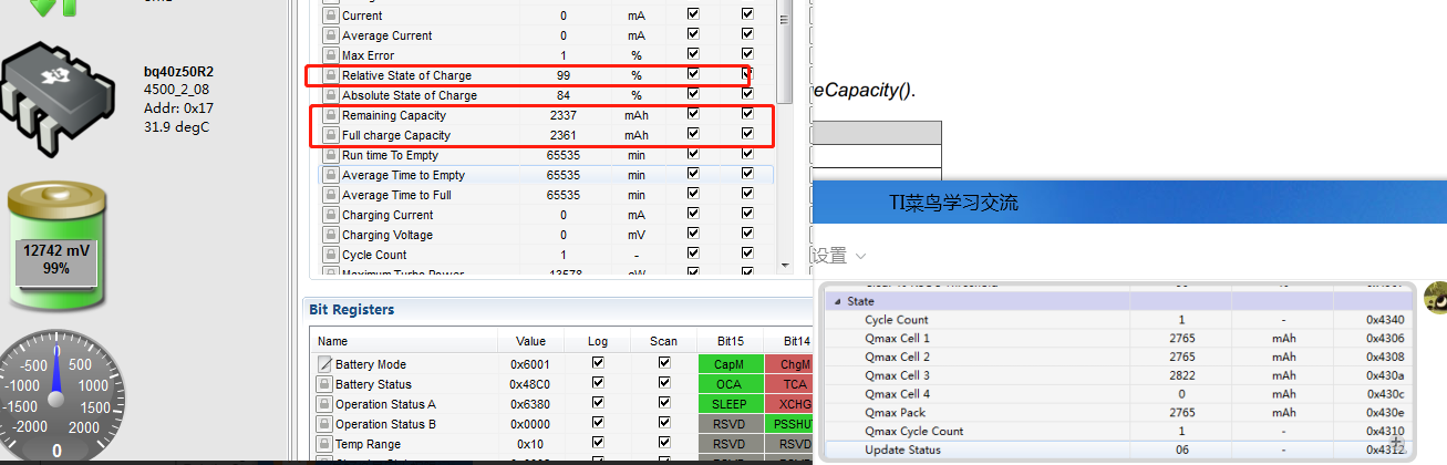

design capacity = 2800mah
qmax has update and see ok, ra table also update, my learning cycle done.
next when i use process, i found when RSOC go 99% the FCC and RC isn't design capacity, why?
