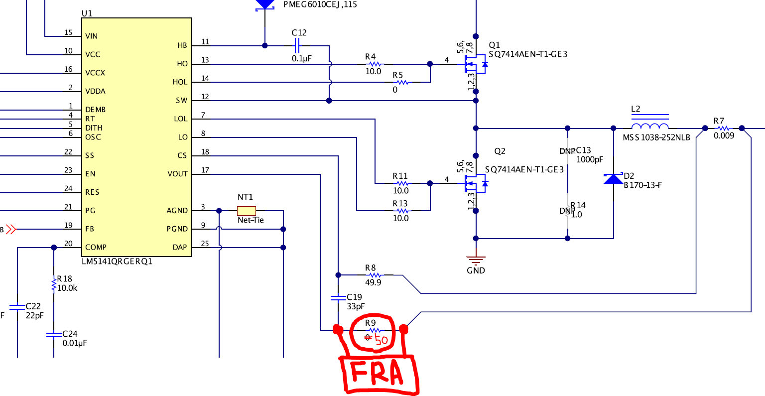

LM5141-Q1: How to measure loop gain and phase on EVM when FB is not used
Part Number: LM5141-Q1
Hello all,
Thank you for your support always. I have a question about LM5141-Q1 EVM.
How can I measure the loop gain and phase on EVM? The FB pin is shorted to AGND so that the output of the device is 5V. I'm thinking replacing R9 with 50-ohm resistor and connect FRA cables at the ends of the resistor like below but I'm not sure.
Or should I solder resistors on the feedback trace?
