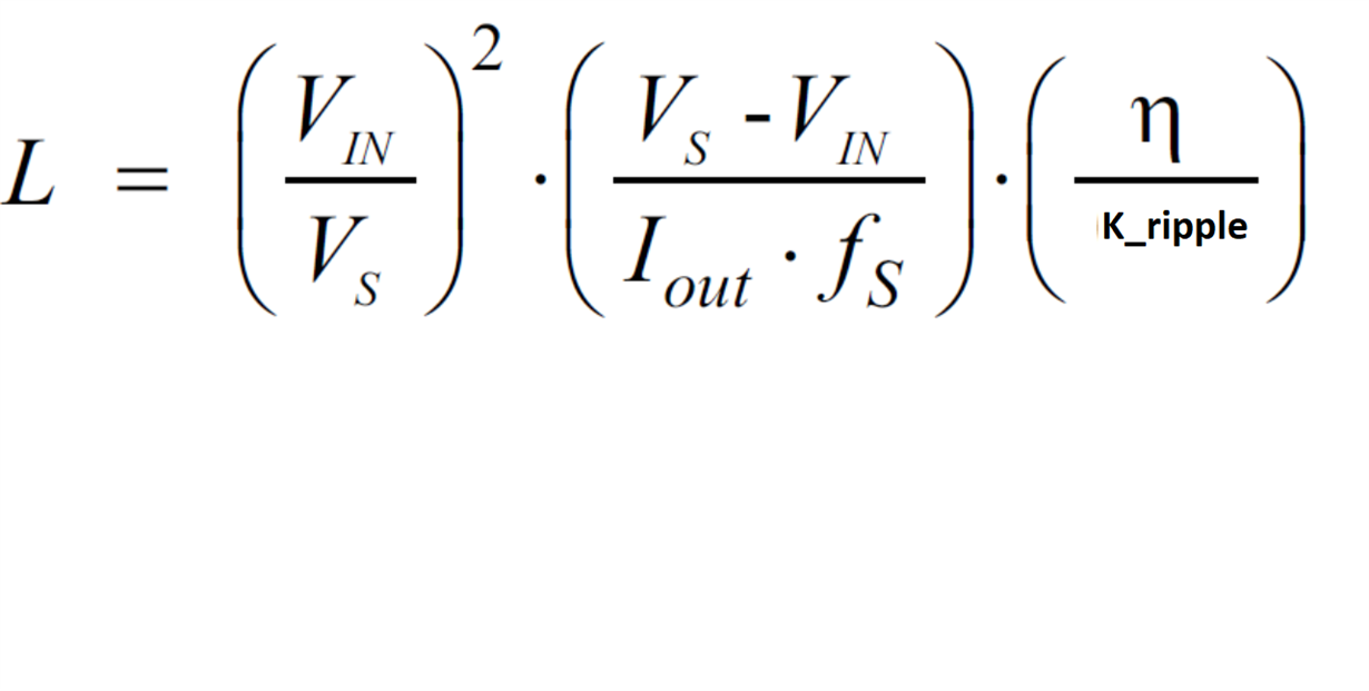

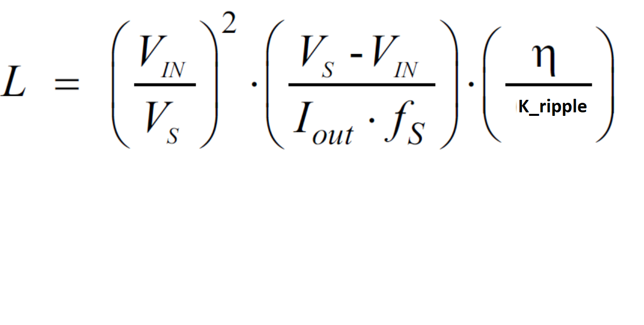

Hi all
Would you mind if we ask TPS61170?
On the datasheet Figure 20. 48-V Phantom Power Application Circuit, the inductor is 22uH.
Could you give us the formula for the inductor?
We would like to calculate the optimum value of the inductor.
The customer's condition is as folllows;
<The customer's condition>
Vin=4V~10V
Vout=48V/10mA
