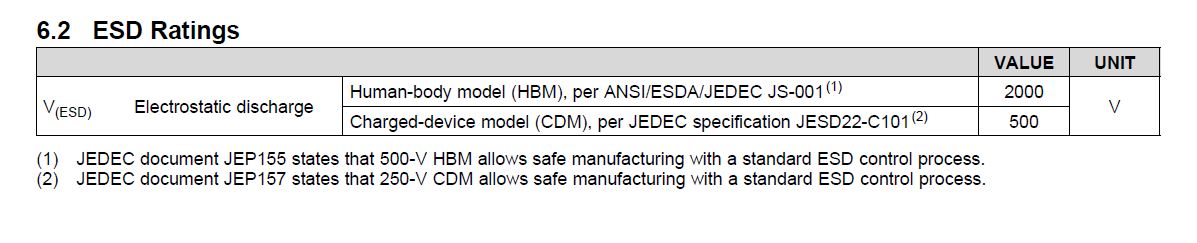

UCC28070: ESD capability
Part Number: UCC28070
Does UCC28070 have ESD capability, amy report if has? Thanks.
