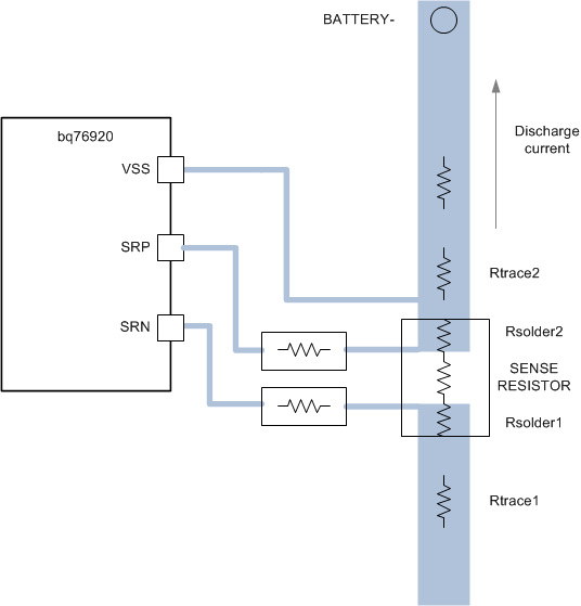

    The connection to the sense resistor should be made with a "Kelvin" connection as close to the sense resistor as possible.  This avoids contribution of the voltage caused by current through the parasitic resistances into the sense voltage seen by the bq76930.  In this picture the bq76930 will sense the voltage Idischarge x (Rsense + Rsolder1 + Rsolder2 + Rtrace1 + Rtrace2).

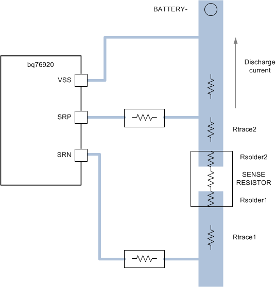

    Routing the sense traces to the pads will eliminate the trace resistance contribution.  In this improved connection the bq76930 will sense the voltage Idischarge x (Rsense + Rsolder1 + Rsolder2).  The resistor still must solder to the board.

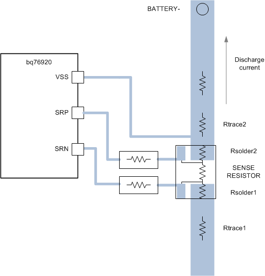

    There are 4 terminal sense resistors made which avoid measuring the voltage across the solder resistance. These are less common.  The high current still causes a voltage drop in the high current path, but the sense connections are in the resistor package and the separate terminals are low current and do not experience a voltage drop.
    Inspect your layout and measure on your system to see if you can find the extra voltage.

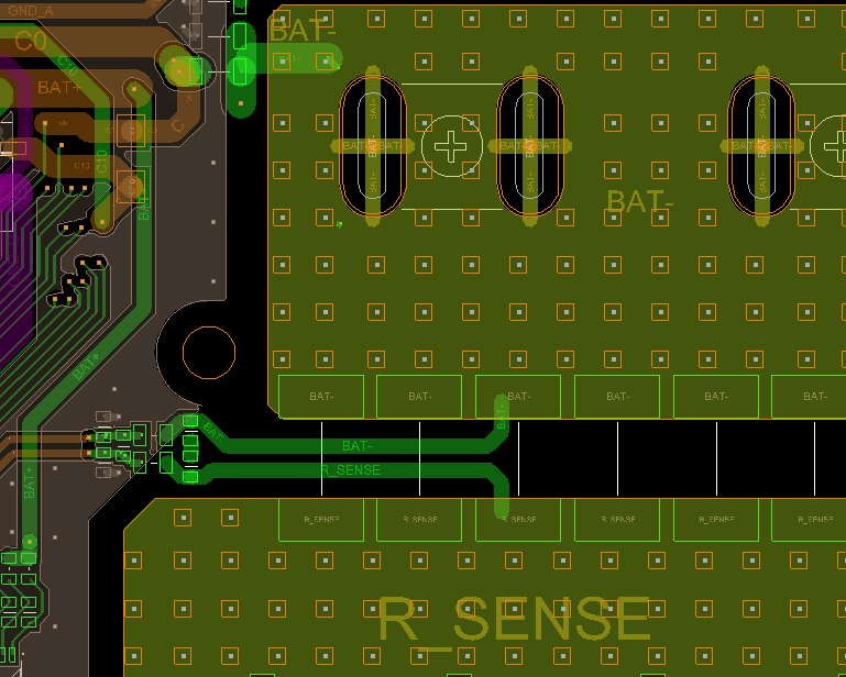

  • Dear WM5295
    Thanks for your explaining, after discussing with our EE and layout team, we did use "kelvin" connection in our layout
    you can refer to the following diagram.
    do you have other ideas about this issue

  • Hi Frank,
    It seems they did a nice job with the layout. I don't know the effect of many parallel resistors, I don't know that we have used more than 3. The sense connection picks up the voltage of the bus at the point of connection.
    My understanding of the solder resistance is it should be small relative to the component value so that it is a don't care. The multiple parallel resistors should help with this. The 4 terminal resistor would also help with this, but would not work for parallel resistors. On a larger scale, there are mechanical shunts where the sense leads are connected to a monolythic part of the sensing material such as wires on a bus bar. That is a large version of the 4 terminal resistor.
    Your board assembly people may know if there is a different solder material or adjustments to the process or volume to give a lower or more consistent solder resistance.
