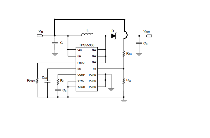

    I am wondering if its possible to use the intern loop control of TPS55330 to regulate the input voltage of the Boost connected to solar panels.
    Rsh and Rsl bridge divider would be calculated to have FB voltage at reference=1.229 V when Vin is at the maximum power point (7V, 4A) and then we would have the output of the intern error amplifier=0. The circuit I want to use is below:
    Is it possible to do that?

  • Hi Corentin,
    We never do in this way, this kind of connection may leads to stability issue.
    Could you please tell me why you want to connect in this way, to make Vo higher when Vin is lower or something else? ..... These information may help us to find out a better solution.

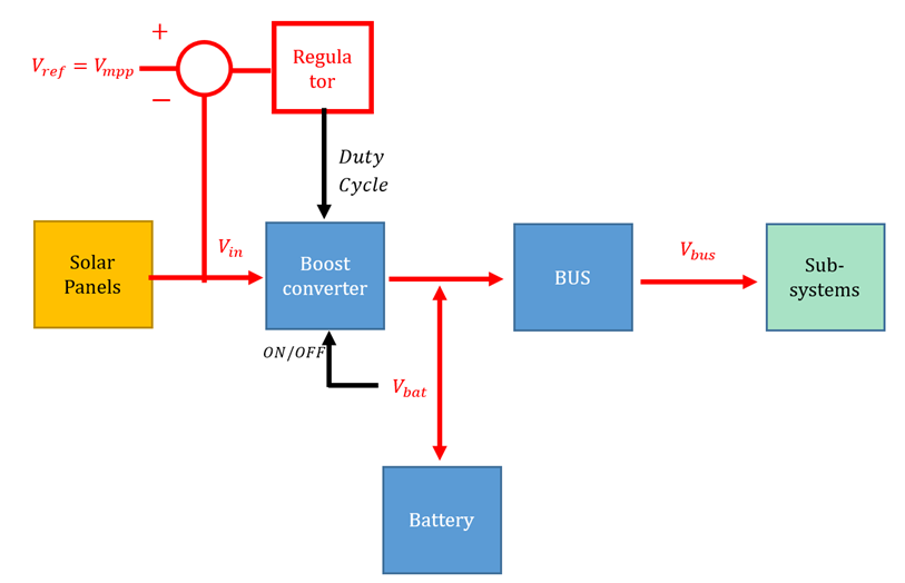

    Thank you for your advice. The block diagram below resumes what I want to do:
    I want to regulate Vin of the boost in order to charge the battery with the maximum input power.
    The Li-Ion battery voltage is 8.2 V when fully charged and sets the output voltage of the Boost.
    The solar panels voltage reaches 7V at MPP.
    I know some components like the charger BQ25703A can handle that but I am looking for a simpler component.
    I have modeled the connection of:
    solar panels input -> the boost converter -> Li-Ion battery
    and the transfer Vin/D (with D the Boost duty cycle) is stable in closed loop. So I want to regulate Vin at MPP when the battery needs to be charged.
    Can I use an integrated component which includes: the command (error amplifier +PWM generator) and the Boost converter ? (like TPS55330 but for input regulation)
    or should I use another component to make the PWM independently and control a Boost with that PWM?

  • Sorry my file wasn't attached in my last answer. This is what I want to do:
  • Hi Corentin,
    For the TPS55330 boost converter, Vo=Vin/(1-D) , so when Vin drops, its duty D will automatically get bigger.
