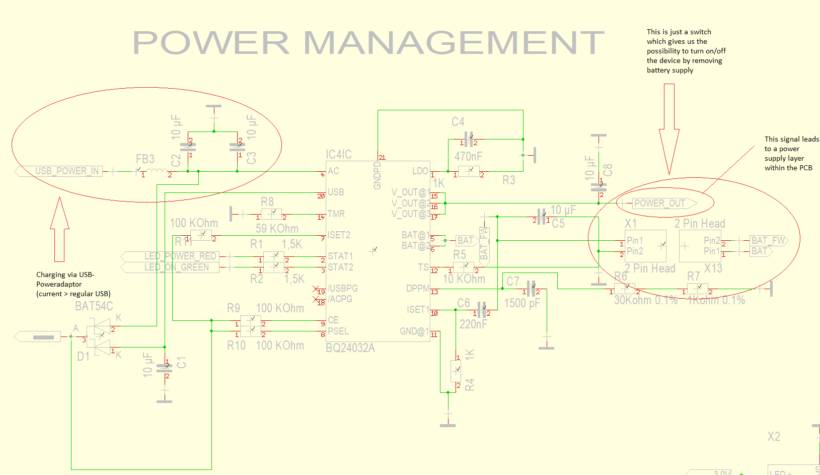

we are using the BQ24032A as a power managment chip in our latest product, which is currently at the end of prototyping phase. Some of our last problems have to be fixed and one of those is the following:
If i am connecting the battery to the IC, with no other supply connected, the IC does not power up the circuit of the remaining application. If i am now connecting a USB cable for charging, the IC begins to power the circuit properly. Also charging is working correctly and STAT LEDs behave as mentioned in the datasheet. We also own an EVAL Board, where the error does not occur but we have less consumers attached to power-out there. Our current circuit will be attached as a picture.
Additionally worth mentioning is that we encounter the strange behaviour of the battery powering-up the device as a standalone power source by approx. 1/50 times (plugging it in and out). If the circuit is powered up (with help of USB) i can remove the USB cable and the battery works fine as a standalone power supply - the problem only affects the powering-up phase.
The consumers connected to the POWER_OUT signal need approx. 400-500 mA (accumulated).
Maybe you have some ideas what causes this problem ?

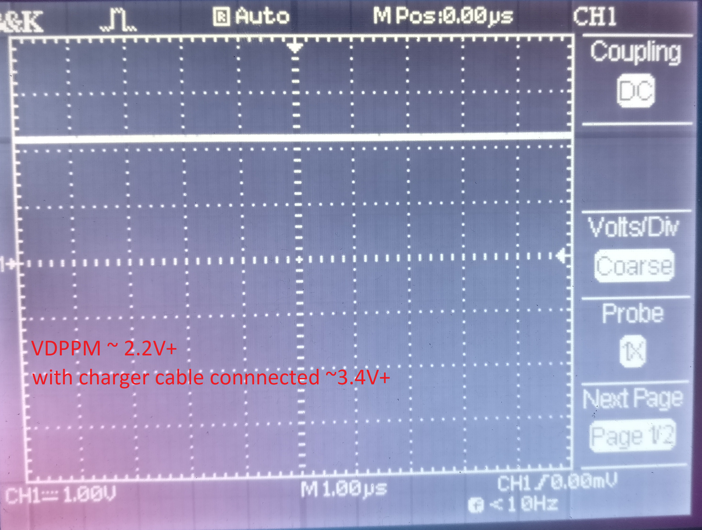

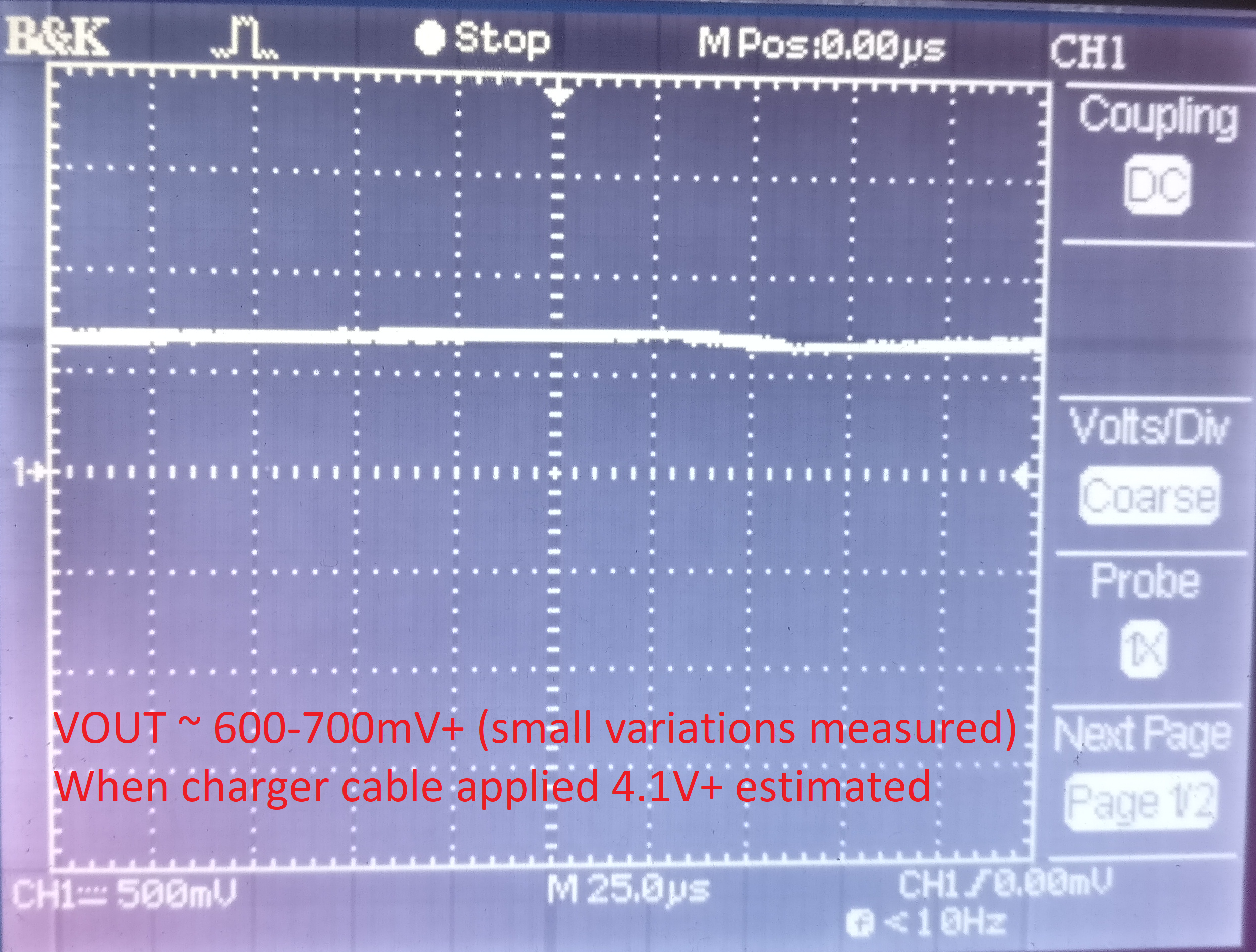

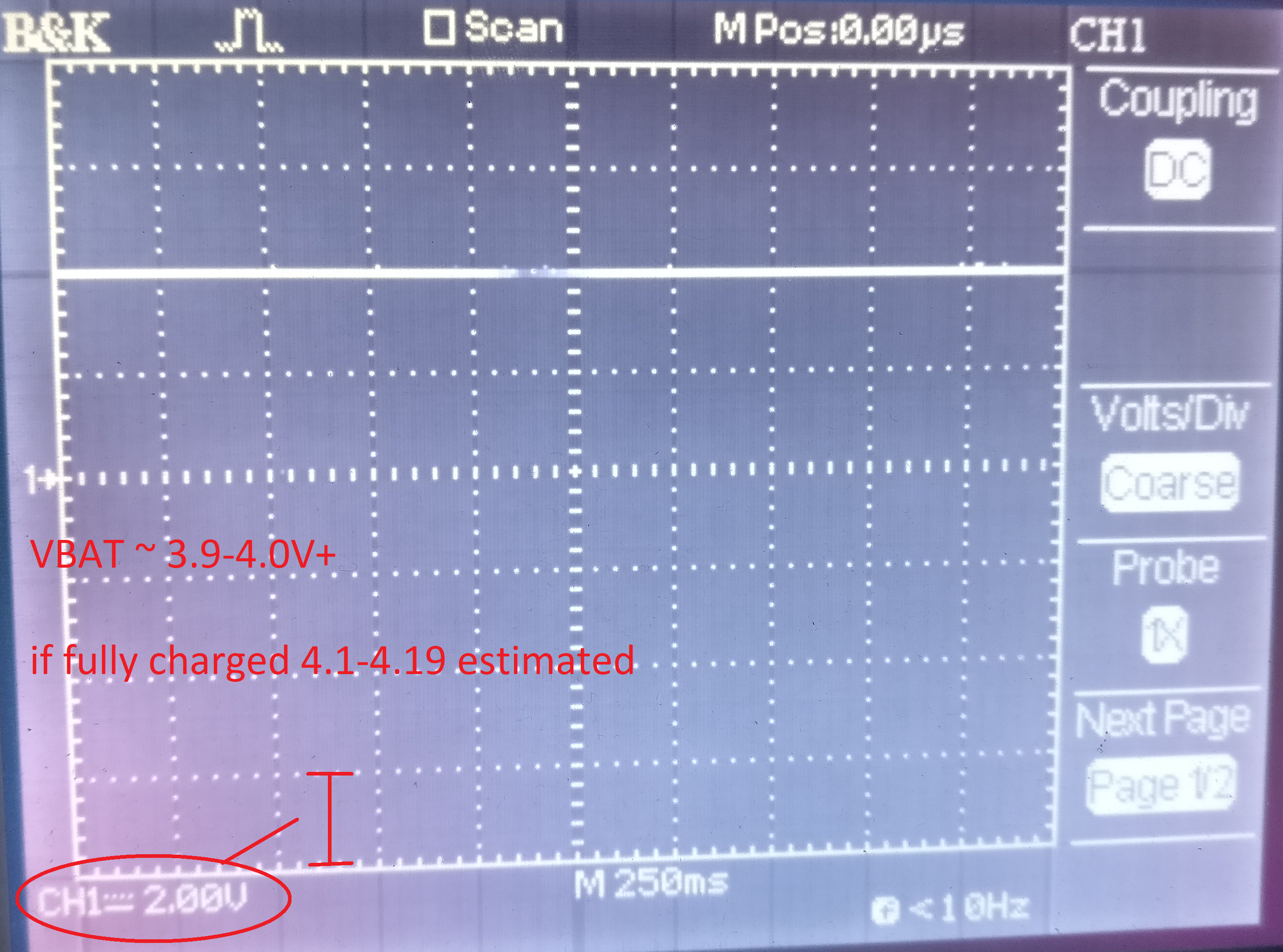

    Can you please post scope shots of VBAT, VOUT, VDPPM and IBAT.
    thank you for your fast answer.
    I have prepared the shots from VBAT, VOUT, VDPPM and measured an IBAT of ~231mA (with some semi-periodic immeasurable peaks when the multimeter displays an overload).
    These measurements were done while the circuit was not powered up and the battery was attached as a standalone power-source.
    Pictures with short description attached below.
    Thank you & Regards,
    Maximilian Majchrzyk
  • Hello,re
    I've tried this in the lab and i can't replicate this issue. The device acts as a passthrough when in BAT only mode so there shouldn't be any problems in this mode. Can you try removing the 500mA load and see if this issue occurs. Also try replacing the battery with a source-meter and check if this issue persists. Also it would be helpful to see a scope shot of the output current and VOUT at the same time.
