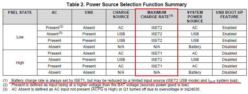

BQ24032A: MAXIMUM CHARGE RATE in Table 2
Guru 29720 points
Part Number: BQ24032A
Hi Team,

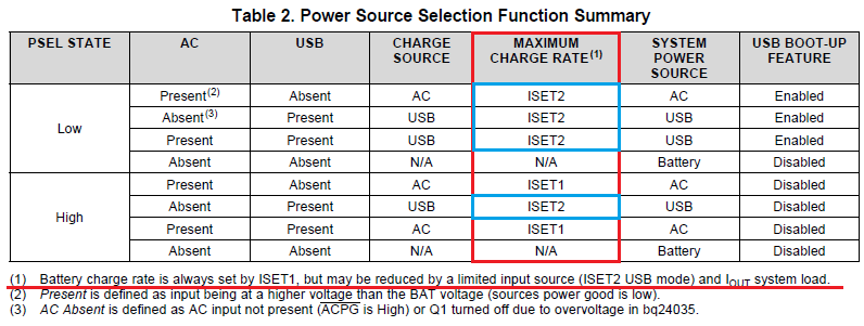

Table 2 shows the following and I would like to ask about note (1).
Should we consider "ISET2" in Table 2 as "ISET1" when we set ISET2= High (500mA) and charge current set point by ISET1 is lower than 500mA?
Yaita / Japan disty
    That is correct. In the event that the current set by ISET1 is lower than that one set by ISET2, the charge current will be set by ISET1 which is lower. However, the input current limit will still follow the ISET2 setting in USB mode if there is a load on OUT.
