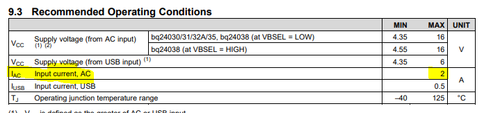

Hi Team,
BQ24032A has two charge inputs AC and USB.
I believe USB has input current limiting (regulation) feature set by ISET2 and AC doesn't have.
Is my understanding correct?
