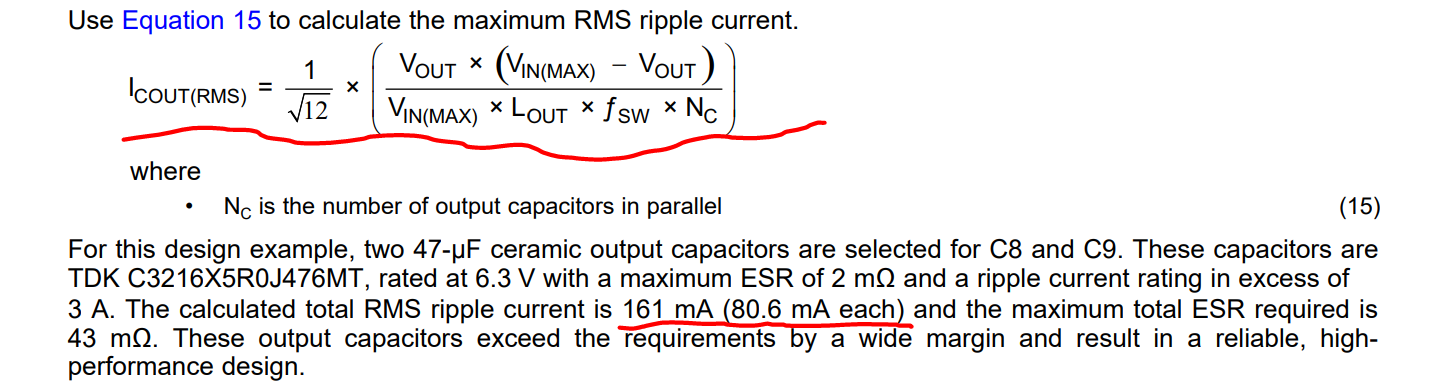

Hi Team,
In the datasheet of TPS54331, i am seeing that the maximun RMS ripple current is 161mA. But I can not get this result according to equation 14. Can you help on this? (3.3*(28-3.3)/(28*6.8u*570k*2))/root(12)=0.751/3.4641=108mA.
