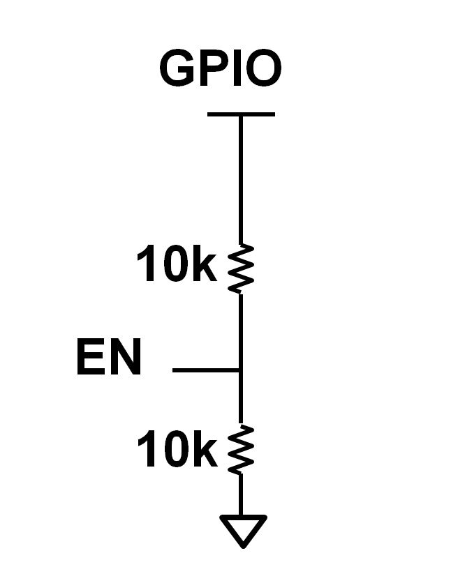

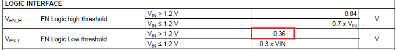

My customer considers to use TPS61021A and controlls EN pin by MCU GPIO output.
I would like to ask about the following "EN Logic Low threshold".

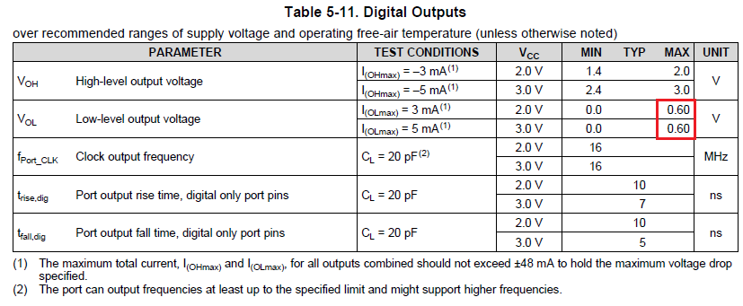

The following is VOL specification of GPIO and shows VOL_max=0.6V.
Is it possible to connect the following GPIO output to EN pin of TPS61021A directly?
If the answer is no, should we put pull-down resistor?
If so is there recommended value of pull-down resisotr?
