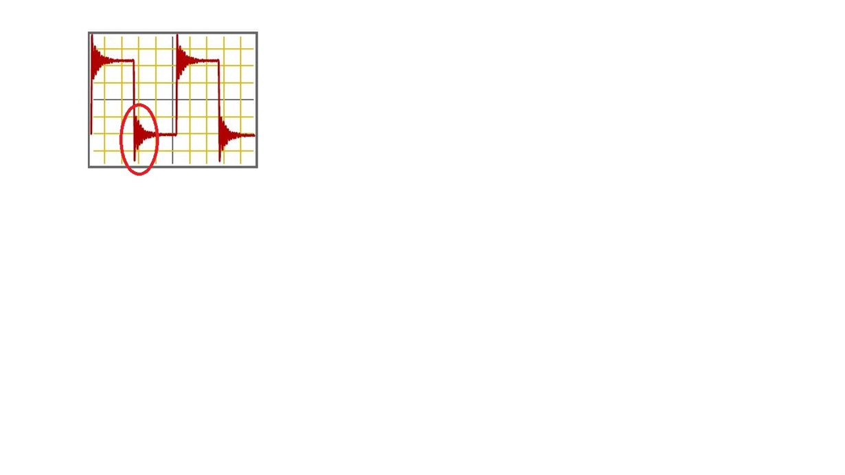

Dear experts, I want to add a snubber circuit at the switching node of bq24610. External DC adapter power source is 24V, battery is 4-serial Li-iron battery(16V). How to choice the footprint of resistor and capacitor(0603 or 0402)? In other words, could I use the 0402 size components on snubber circuit(for example, 2 ohm resistor and 2.2nF capacitor). Regards.
