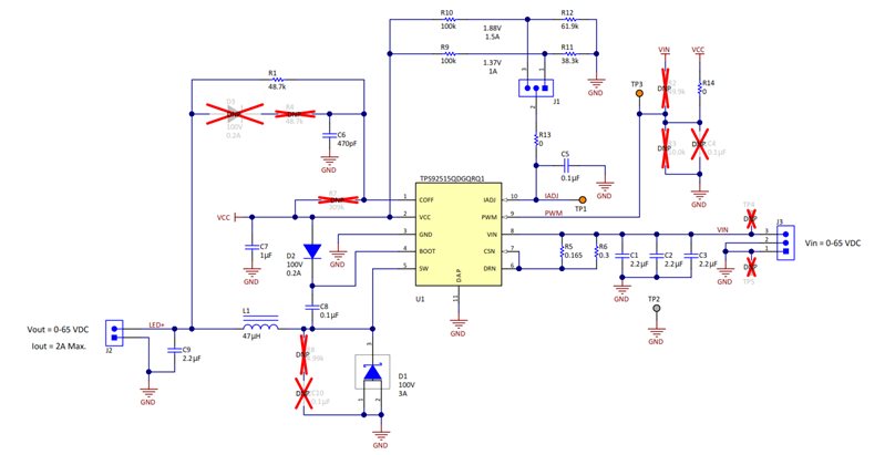

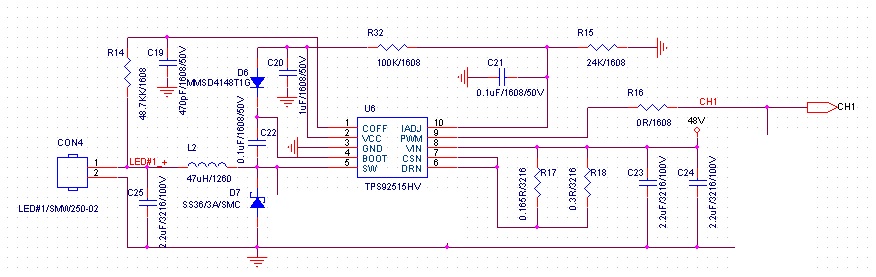

I made a 3CH LED Driver using TPS92515HV.
It will work by DC 48V.
It was included of 8bit MCU and LM5009, TPS92515, etc.
The MCU was generated 10KHz PWM to control the LED driver.

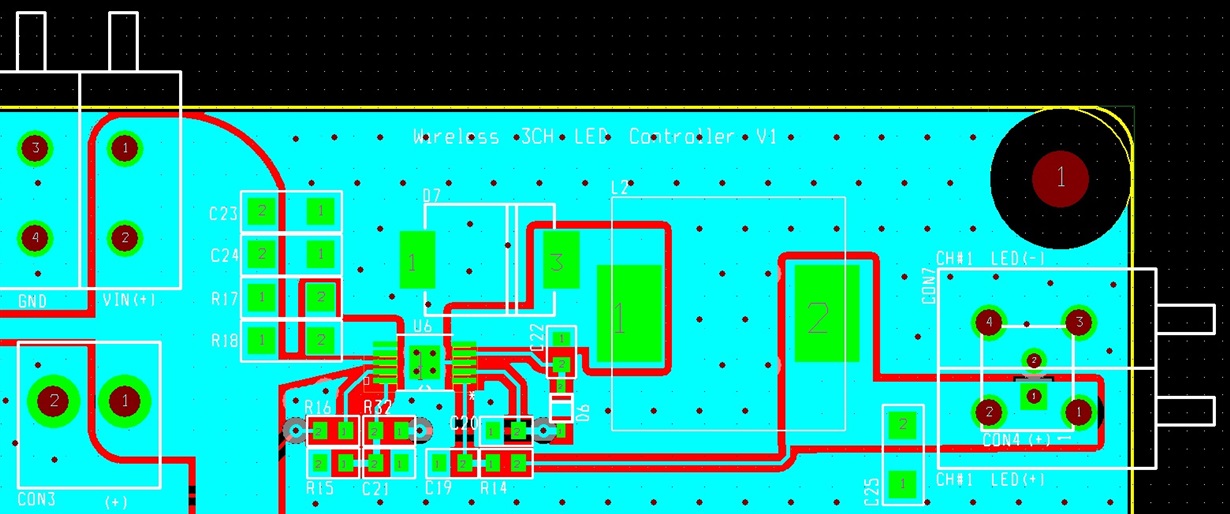

Below PCB layout

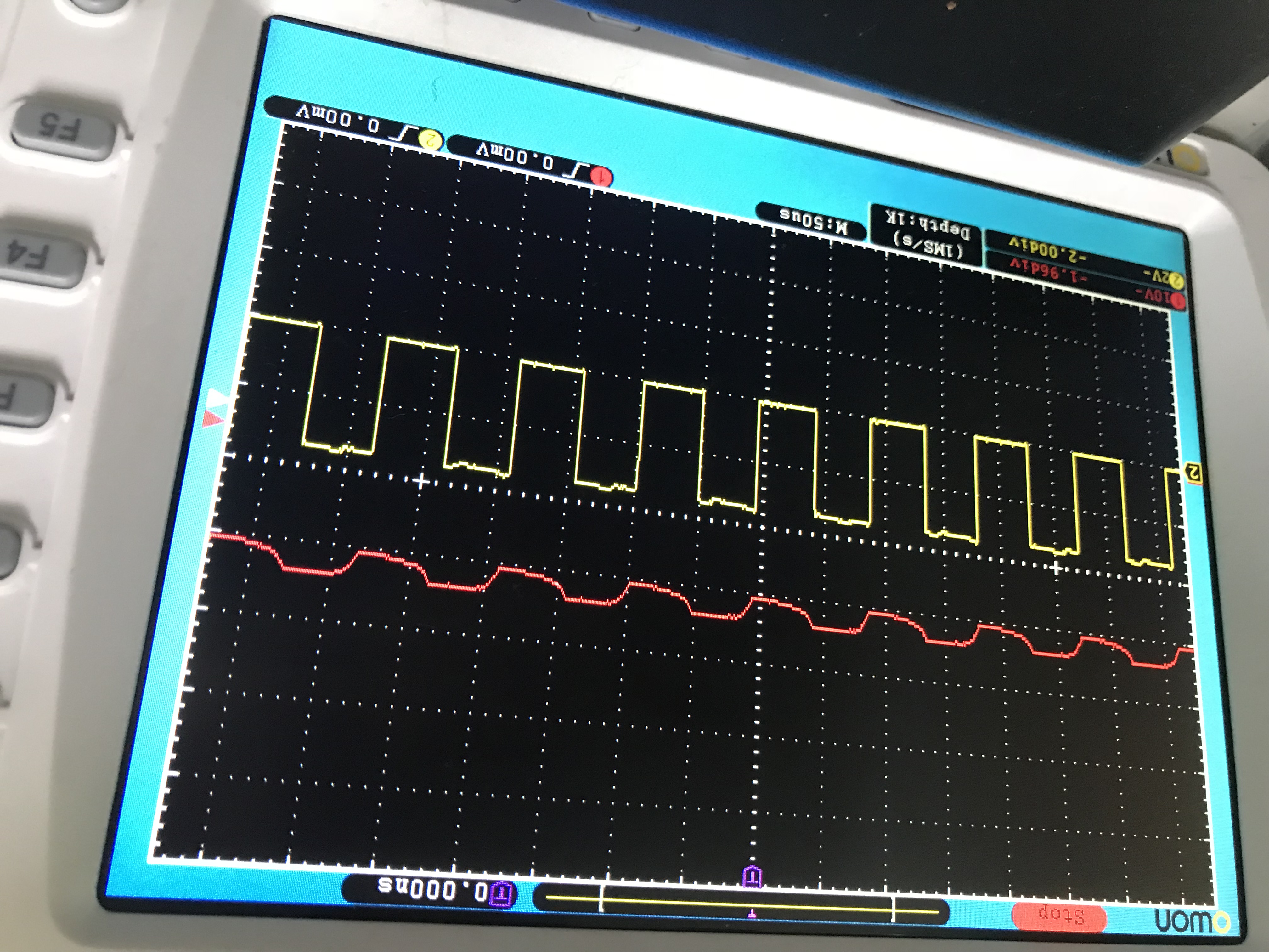

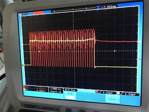

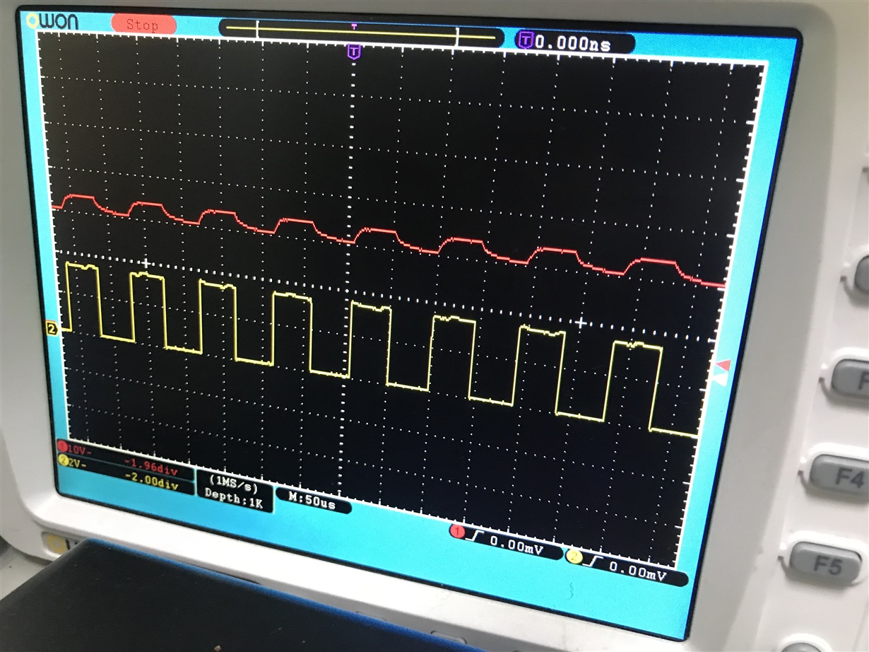

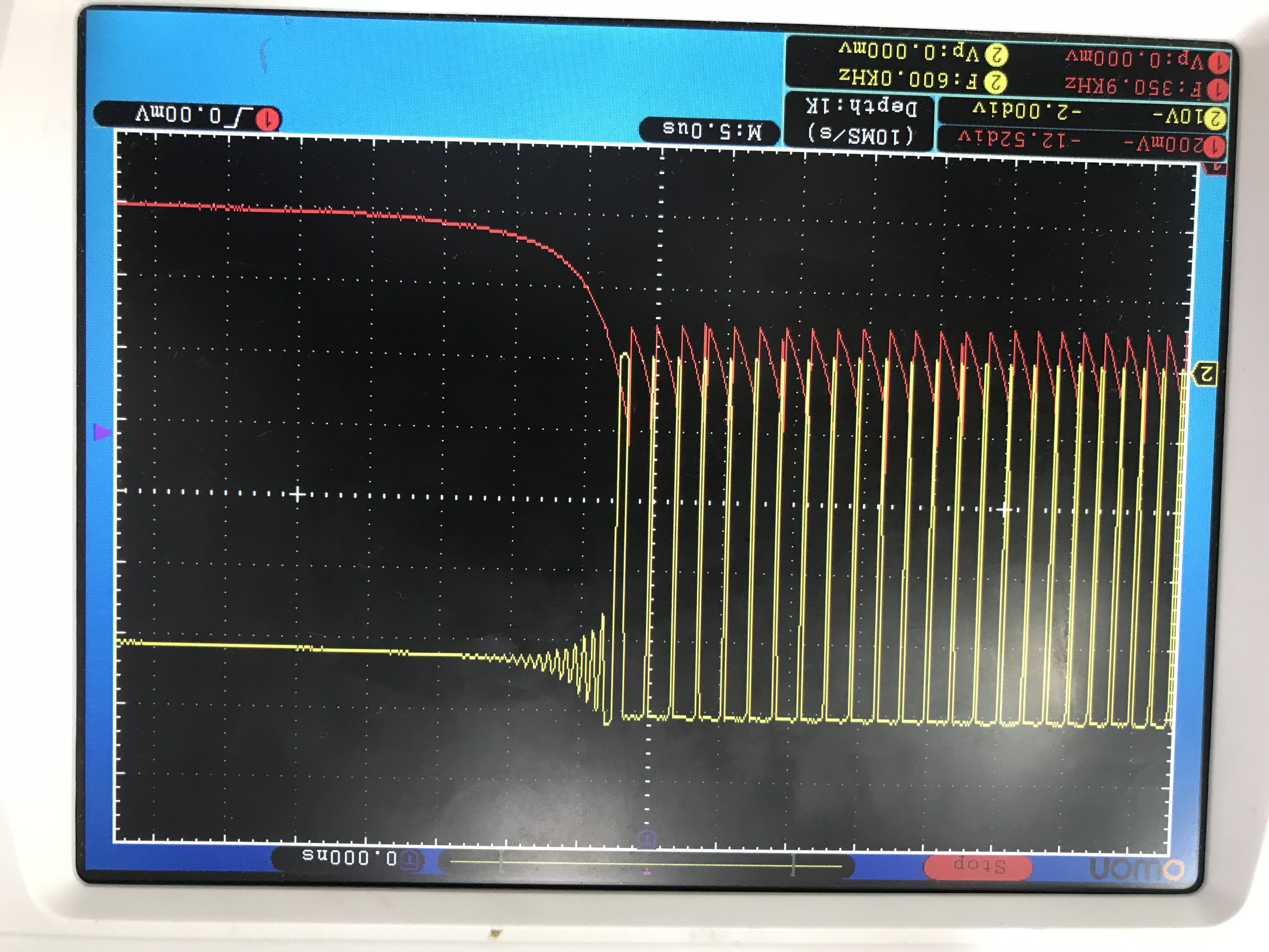

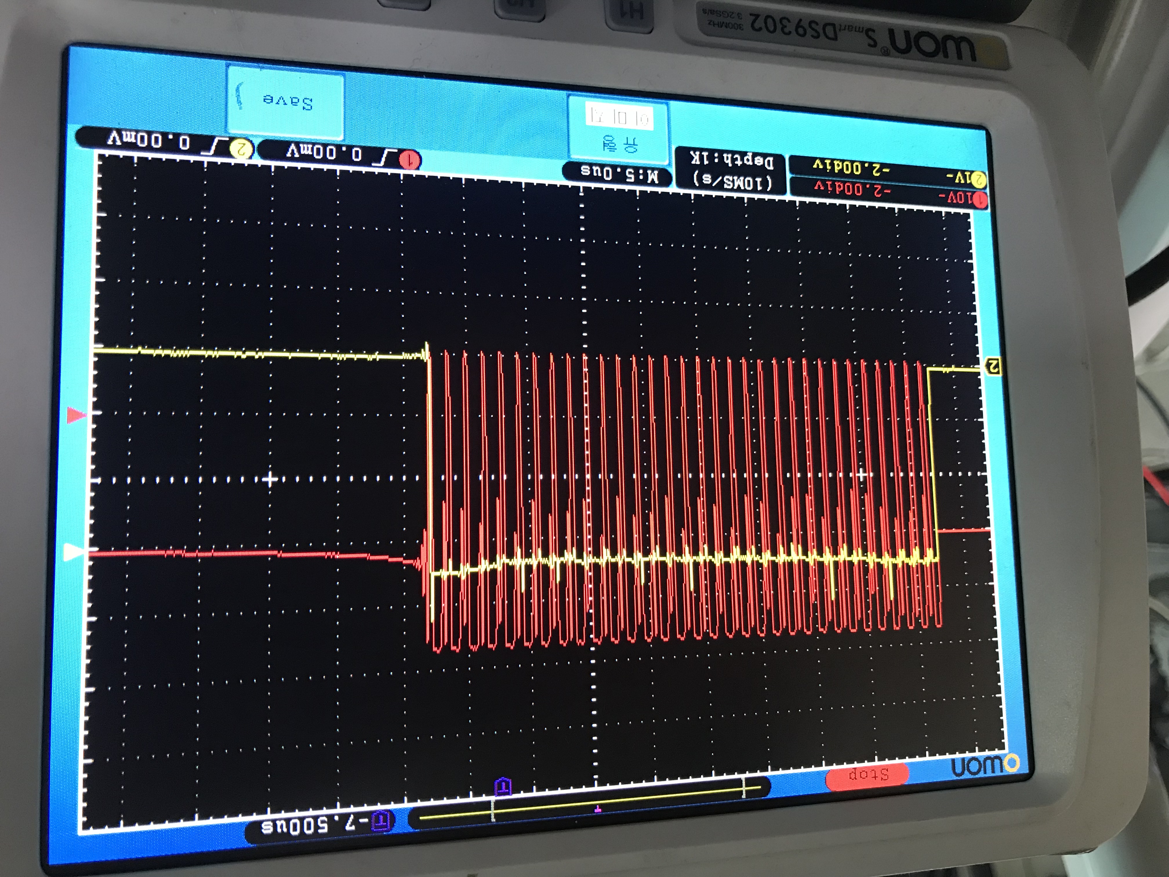

L2 Inductor was making a ringing noise.
LED has flicker sometimes.
CH1 was SW pin, CH2 was PWM CH1.
Where should I fix it to improve?
