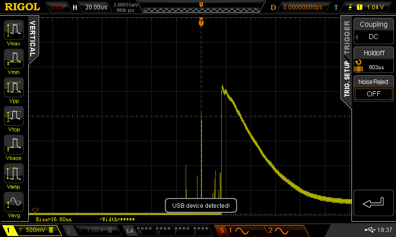

We have blown the sense resistor on 5 out of 20 when plugging in the battery (LiIon). Current transient in the attached is about 2.5A (about 2.5V across 1 ohm resistor in series with battery). The transient is well within your published spec.  Any idea why this might be happening?
