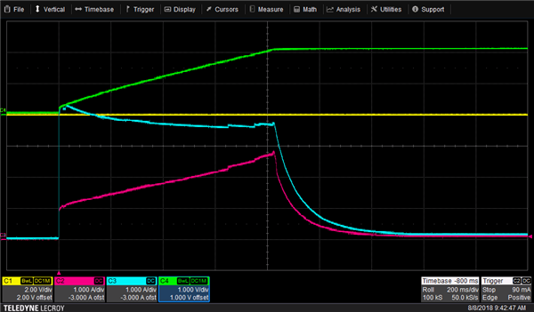

    Note that the 400 mA average current limit refers to the input side (the high side switch of the buck part), therefore not the inductor when the device operates in buck mode. This limit increases linearly as the output voltage increases from 0 V (short circuit) to somewhere above 1 V. On top of that, there is a 4 A limit for any switch. The 20% limit on duty cycle is for normal operation, not when a limit is reached.
    Therefore, the second scenario will happen, however, not with a constant D since there will be current limiting somewhere.
    As an example, these are the curves when charging a ~2 F supercap to 2.1 V:
    Input voltage: 4 V
    Output voltage: green
    Input current: red
    Output current: blue
    In this case the limit is dictated by the output current reaching 4 A limit. The input current ramps from a value higher than 400 mA because the output voltage does not start from zero since there is some resistance in the leads and supercap's ESR. In other cases the input current limit could also prevail.
    Milos
  • Thanks Milos, the scope screen capture is especially helpful!I was concerned that the 20% minimum duty cycle limit was a hard limit (for bootstrapping the gate drive or something like that), but apparently the converter operates fine at a lower duty cycle on start-up.
