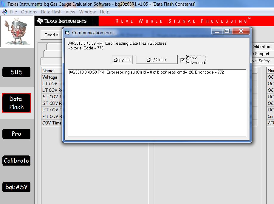

  • So I reinstalled the bqEVSW with the latest on the bq20z65R1 page. Reinstalled the support components. As before, it goes straight into the dataRam screen withou having to select anything. SBS data is being read without an issue. Data flash creates the attached message.
    The status line also shows the slightly more readable "No Acknowledge: VB_T2H_NACK"
    I think I read somewhere that the device might be
  • ... might be locked, but I can't figure out where that would be indicated in the SW.
  • If it goes straight to the SBS screen and RAM can be read normally then it sounds like autodetect is working. Typically you get an error reading dataflash when the gauge is in SEALED mode, because Data Flash reading is blocked when sealed. What are the values of these status bits in RAM? SBS:OperationStatus(0x54)[SS],[FAS]
    Can you also attach a screenshot of the SBS screen after a successful read?
