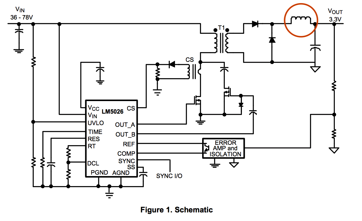

Hi
    I am designing a LM5026 bases DC-DC converter, I have downloaded all public resources, but no inductor selection table was found, could someone give some hints or better inductor selection guide? Thanks.
  • Hi
    The value of the output inductance is driven mostly by the level of ripple current in the output that your design can accommodate. For example a design with 15% ripple current for a 10A max load current would have 1.5A of ripple current. The ripple current needs to be filtered by the output capacitance which has some ESR. The ripple current will create a voltage drop across the ESR which will result in the output ripple voltage.
    It really is a balancing act between the output inductance value and the value and type of output capacitance used in the design to meet the output ripple voltage spec.
    There is a design calculator for another TI active clamp controller which contains a calculation for the output inductor which may be useful.
    www.ti.com/.../getliterature.tsp
    Peter
