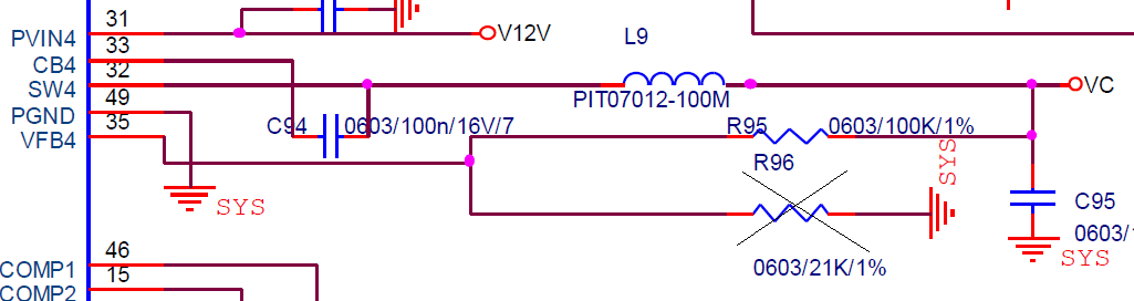

We got a problem about VREF_COMMAND(D8h) setting.
Customer remove low side feedback resister and measure output voltage, customer think Vout = Vref in this case.
When they set D8h = 0x00h, they got Vout = 0.65V, this isn't match with spec. they set D8h = 0x7Fh, they can got correct value ---- 1.87V.
Any possible cause make this issue?
Customer's schematic as below.
