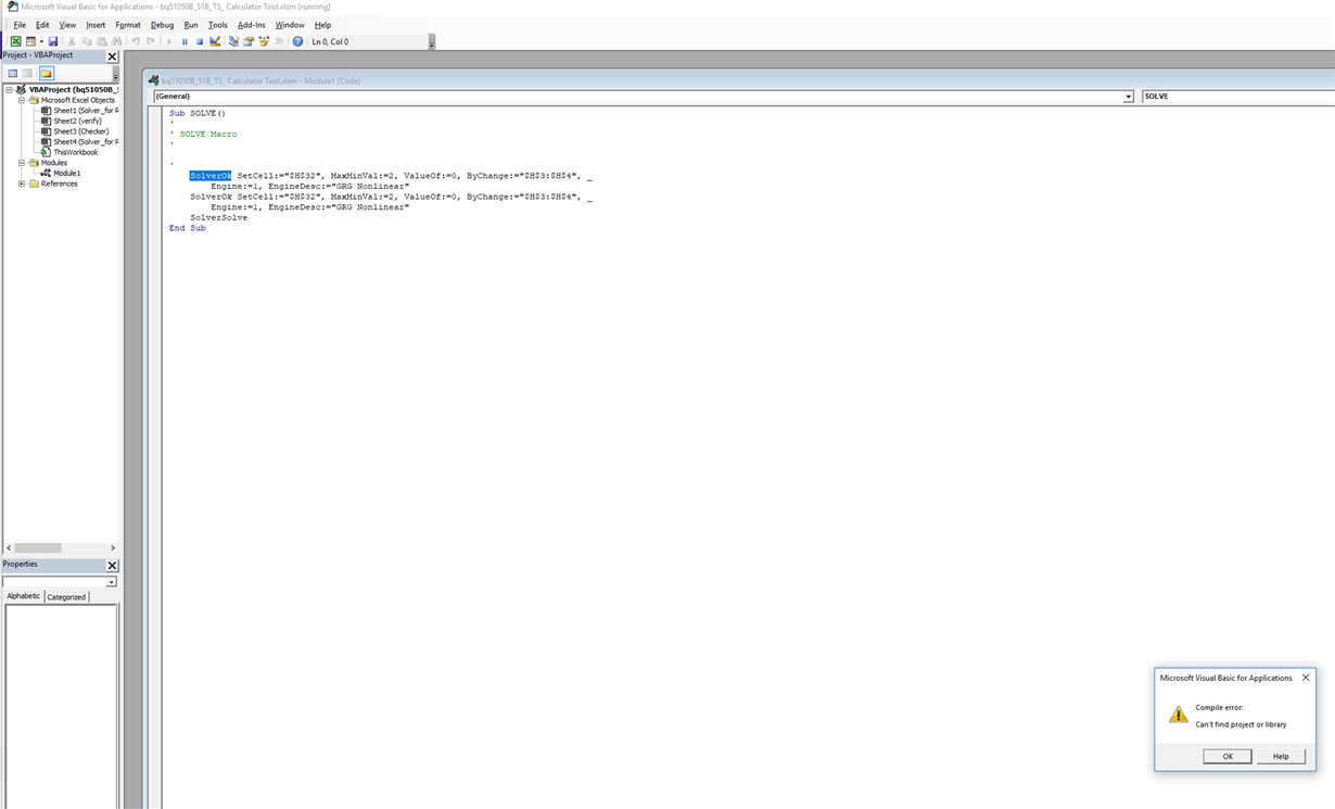

We've come to the realization that the TS / NTC macros fail to run and so we can't calculate the values for our design.
Do you have an updated spreadsheet or could you please provide the resistor values for 0-45°C? We currently use this thermistor (3380K): ERT-J0EG103JM but are open to suggestions as we are going to have to update and re-fab our boards.

    I found the thread where you help someone solve this issue for the same temperature 0-45 C, however finding a 6.8k with 4500 beta has proven somewhat challenging. Is there a way to get a copy of the spreadsheet that works so we can better adjust the NTC for availability?
    The image attached is the problem we always get when running the solver; this was attempted in Excel and LibreOffice with similar results. Also, we downloaded it multiple times without success.
  • I will contact and we can work this problem off line.
  • Just a quick update -- we know that the Win 7 will have problems with this file.
