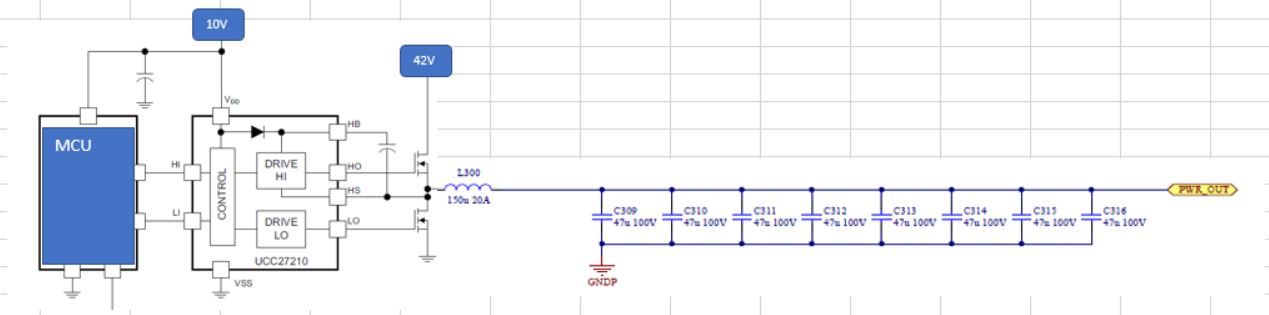

I am looking the UCC27211 gate driver for our project.
-- Description about project.
 -  Application : Solar  /   300w Power optimizer   /  DcDc Converter _buck type  PWM duty 50~90% , frequency 40khz  /
  Below is draft Schematic.
So I have some qustions. I  need your help.
1. can you recommend "FET" for the hi side and low side ?  I think that  Qg  ,Rds ,Ciss ,Coss ,etc. of FET are very critical point for the stable .

    Here is draft sch.  [ Not UCC27210  , I am using UCC27211  ]
    Can you let me know that if it  has to be additional parts and circuit  with your suggested parts?

  • Hello Sean Do,
    Thank you for the schematic.
    Regarding the additional parts. I would suggest adding provisions for a small capacitance on the LI and HI pins to VSS placed very close to the UCC27210 IC. Also I would suggest adding a series gate resistor, or resistor and parallel diode between the driver HO and LO outputs to the MOSFET gate terminal. You can start with a resistance of 2.2 to 4.7 Ohms and evaluate in the testing. You will want the ability to control the MOSFET turn on transition in order to minimize the switch node turn on voltage spike and stay within the MOSFET VDS voltage rating.

  • Hi Richard Herring
    I need more detail description about below list.
    1. Reason why series gate resistor and parallel diode need to use to this SCH . What it is role with this circuit ?
    2. How to decide value bootstrap cap ?
    Can you let me know how to get CSD19533 and CSD19531 by ti sample services system?

  • Hello Sean Do,
    For the questions 1 above regarding the gate resistor and parallel diode. This is a recommendation I make as good practice on a new design to accommodate the ability to optimize the performance of the converter. The gate resistor, and ability to adjust, will provide the ability to slow down the switching of the FET's if desired for several possible reasons. One is to reduce the dV/dt on the switch node to reduce the emissions to meet EMI requirements. Another in a buck converter as you show is to reduce the switch node turn on spike during the turn on of the high side power MOSFET.
    The parallel diode allows for having a faster turn off VGS than turn on. After testing, you may determine these components are not necessary and can just install a 0 Ohm resistor. I would at least recommend a gate resistor on the schematic to allow adjustment in the design.
    For the boot strap capacitor I would recommend reviewing Section 9.2.2 in the LM5101A datasheet which is a similar 100V half bridge driver. The link is:
    http://www.ti.com/lit/ds/snosaw2q/snosaw2q.pdf
    The datasheet also provides guidance for selecting the gate drive resistors.
    For the samples if you go to the product page for the CSD19531Q5A and the order now tab, there is a request sample tab where you can get samples for no cost. If you want more than one sample click the Edit button. See the link below:
    http://www.ti.com/product/CSD19531Q5A/samplebuy
