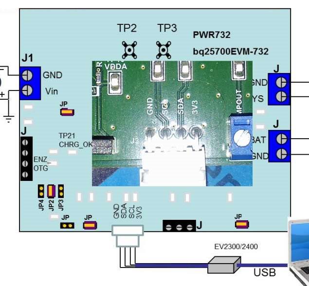

Figure 2  of BQ25700A EVM DataSheet is erroneous: lines SDA and SCL are inverted. But the labelling of top silk on the EVM PCB is correct: from left to right, one must read GND, SCL, SDA, 3V3. This can be confusing when attempting to program BQ25700A with your own host (not EV2400).
Maybe a DataSheet correction?
