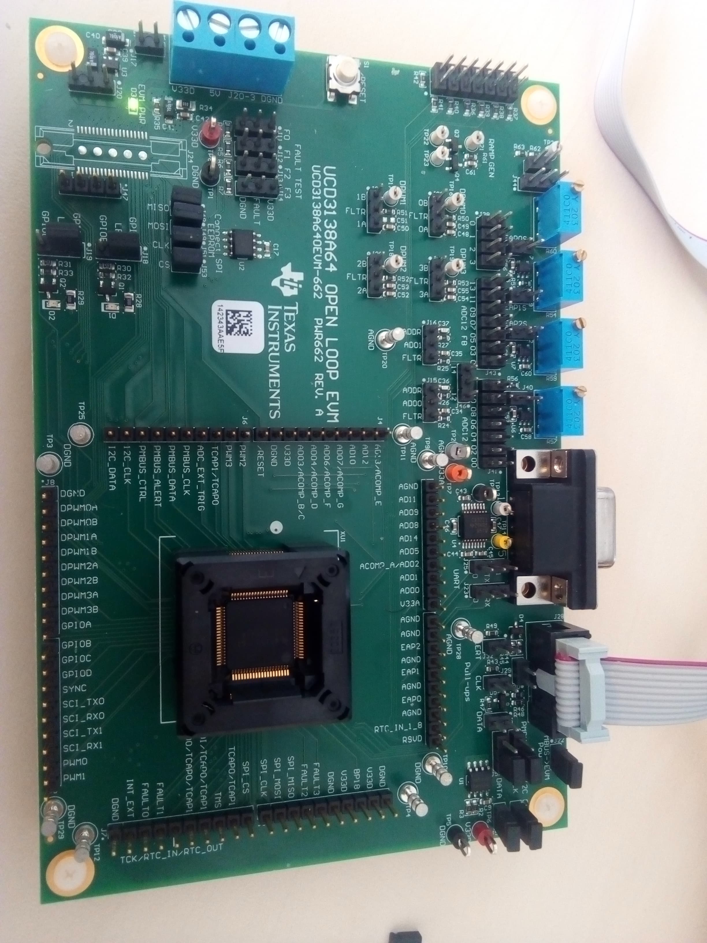

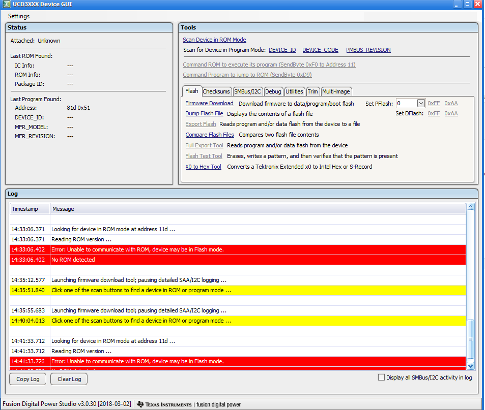

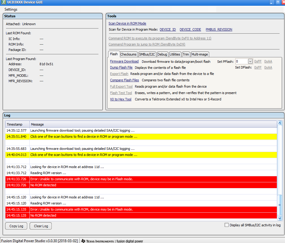

Good Morning I have the same card ,
when I put the USB , it's okay the LED is on  , But when I use Device GUI it say that no rom detected unable to communicate with rom , device may be in flash mode .
Please help me  , the GUI can not recognise my card i don't dowloaded any program
Always i have red errors even i click scan device in rom mode also device id same problem
pleasse help it's urgent
thank

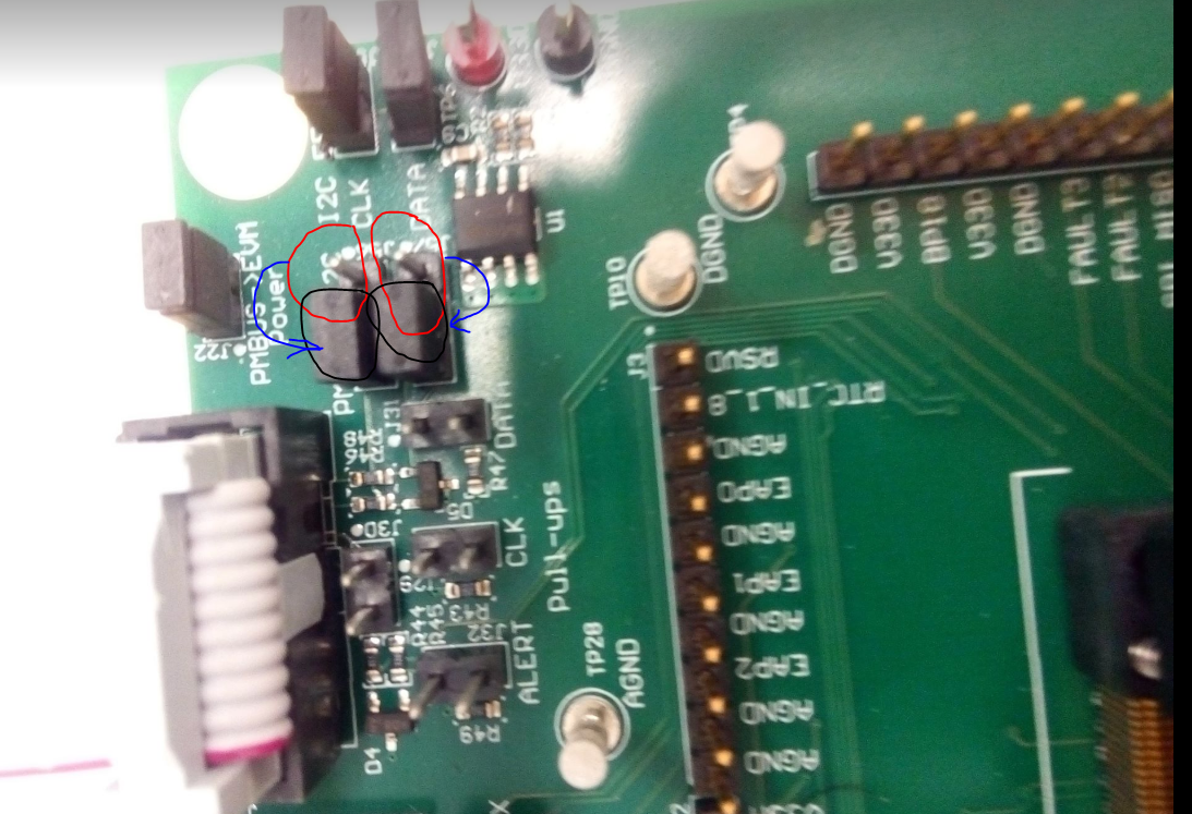

    Make sure the device is placed properly. Measure BP18 in the good voltage? Measure PMBus Data and Clock are pulled high?
    Sean
  • Thanks for  your prompt reply !

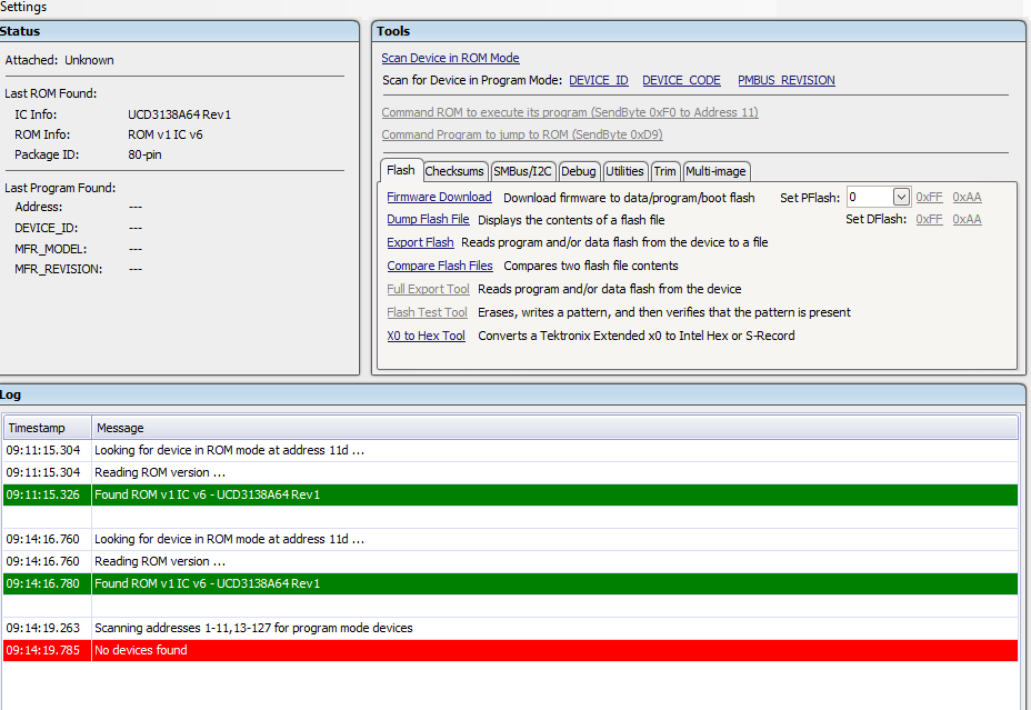

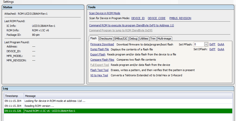

    I changed the position of the jumper of my card of PMBUS DATA and CLK .
    And I got this  , when I do scan  device  :

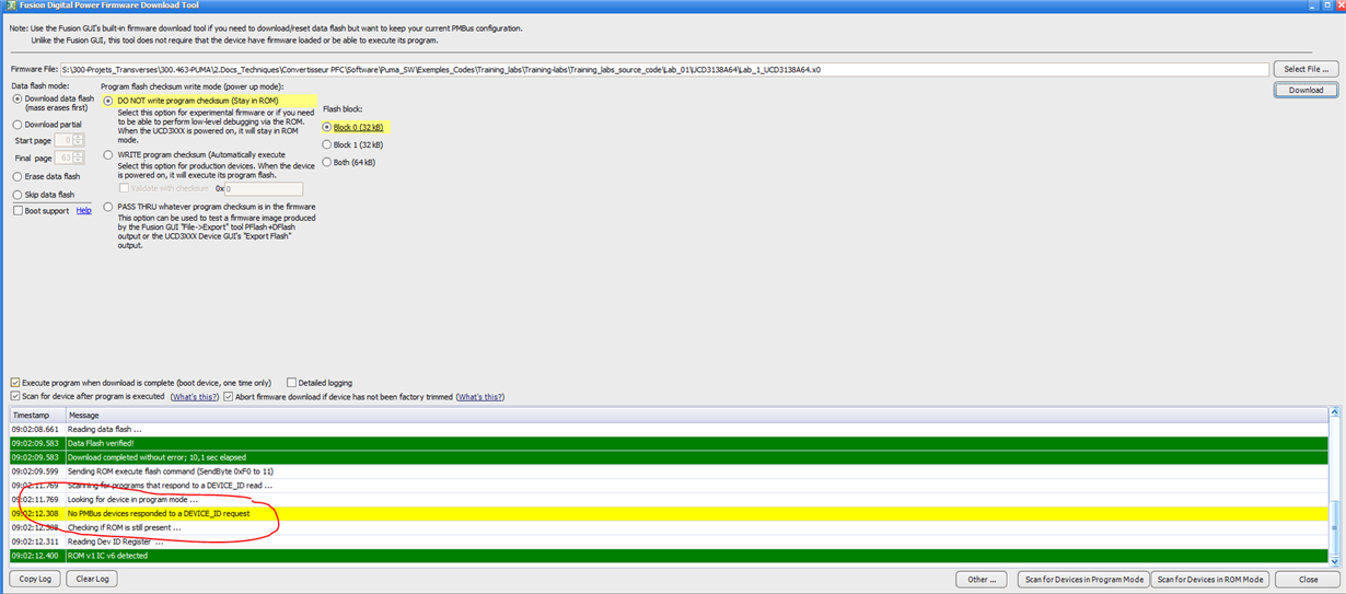

    I thought , it worked , I tried to dowload some example of labs  but it didn't work .
    I retried to scan the device and then " command rom to execute its program (sendbyte 0xF0 to adress 11) but no improvement :/
    what can I do  , thank you
  • Hello it looks like you have gotten the device in ROM mode and have successfully downloaded the program. An engineer will offer further advice.
  • If you look at main.c in the lab, it will probably say this:
    // enable JTAG
    MiscAnalogRegs.IOMUX.all = 0;
    // IMPORTANT: READ BELOW, OR CODE MAY NOT EXECUTE CORRECTLY
    // tie pin FAULT3 to ground for normal operation
    // tie pin FAULT3 to 3.3V to clear checksum
    I hope it is also mentioned in the video. If you tie the fault 3 pin to ground, this will probably solve your problem. This is the ROM backdoor, which we encourage you to use. It is very easy to mess up the program after this point, and set the checksum and lock up the device. With this, you have a reasonable chance to be able to recover. It's still not fool proof, though.
