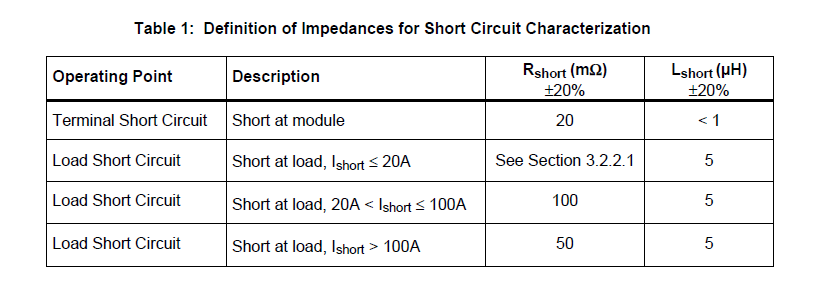

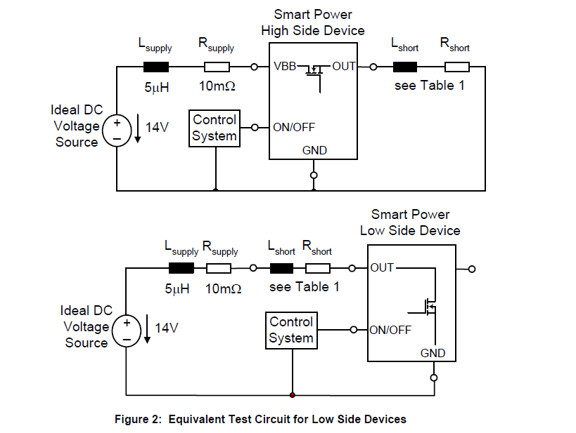

My customer is considering to apply TPS7B6750-Q1 for their system.
Sounds like, OEM is requiring AEC-Q100-012 short circuit reliability on IC's.
Sorry to ask this kind of matter, but I would like to answer making concensus with
you for them. Please give your advice.
1. I wonder AEC-Q100-012 testing is implemented for TPS7B6750-Q1?
2. If no, Could you please let me know the reason why no implementation.
For instance, the target device of AEC-Q100-012 is embbed FET & integrated
protection function as IPD(Intelligent Power Device). And it for off-board leads(indicated as "Lshort".
TPS7B6750-Q1 is presupposed on-board.
