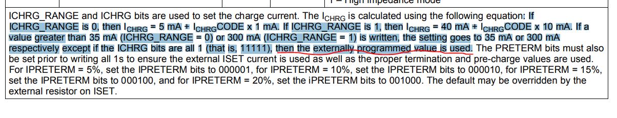

Dear Sir/Ms.
In Table 15 mark in Red line seems not correct. I verify with EVM. If ISET resistor wire to GND, I don't need to set this register.
Would you please help to double check and update datasheet?
Kami Huang
Dear Sir/Ms.
