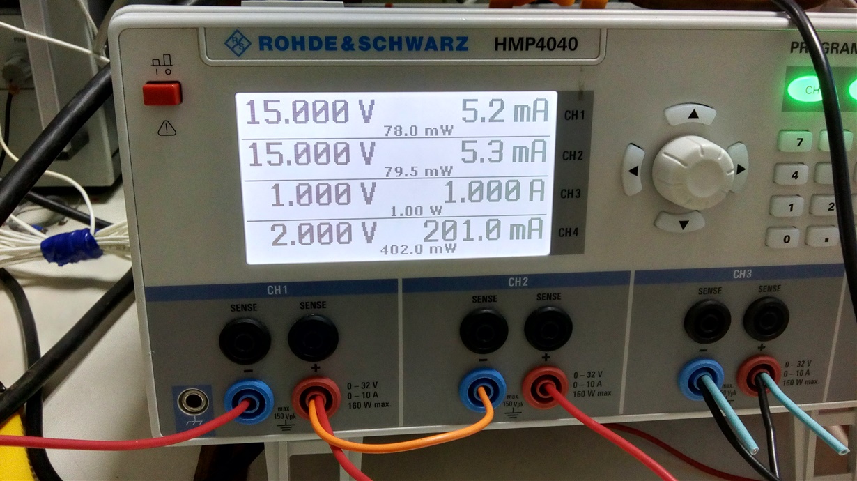

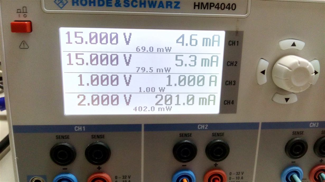

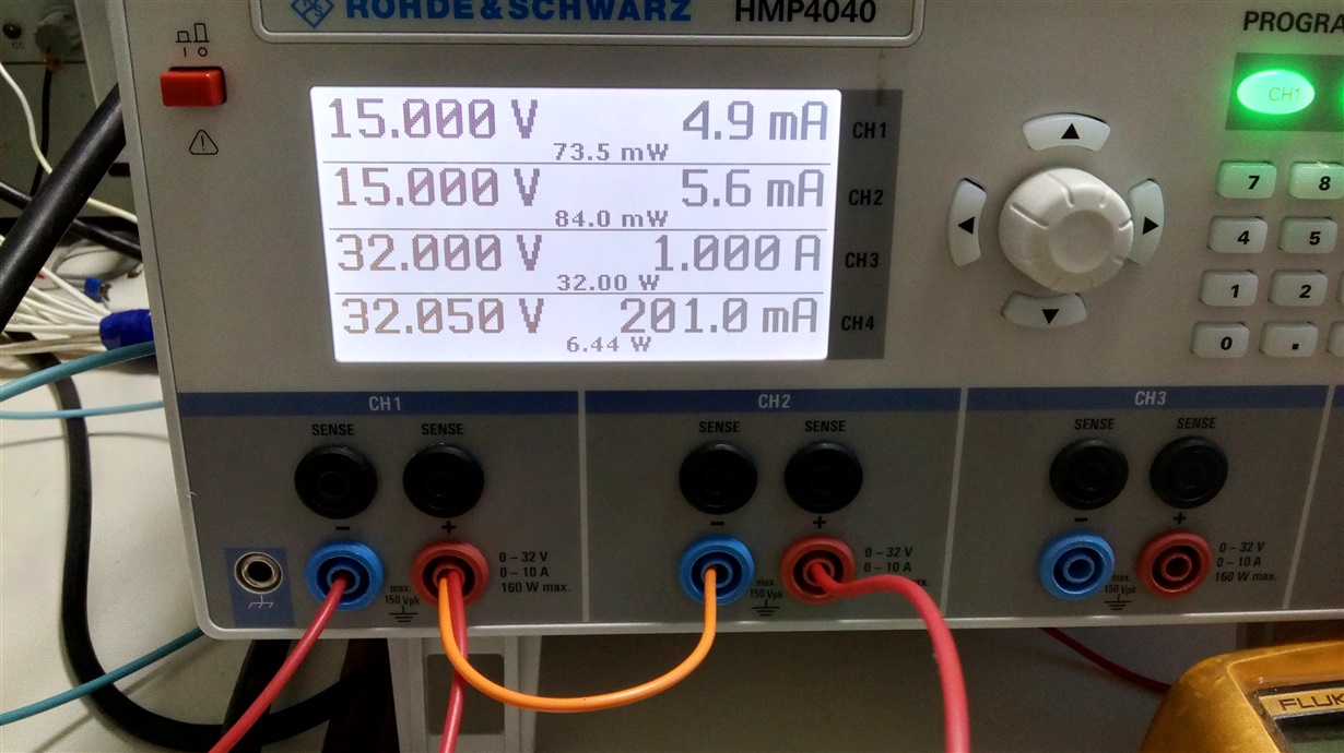

    3) The sections which were powered by the DC-DC converter were also checked for its functionality but the loading didn’t seem to be an issue. I am sending the screenshots of the load currents of the sections of the boards which are powered by the not functioning DC-DC converter. In the photos channel 1 and channel 2 were used for powering up the PCB.
