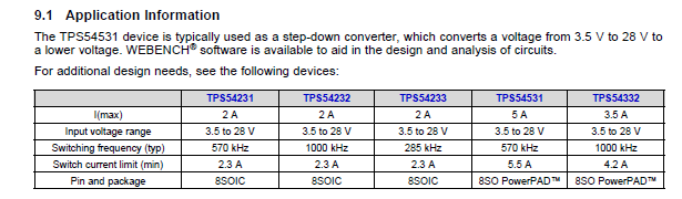

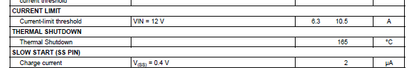

We have question for TPS54531 current limit. The current limit values are different in sections 7.5 and 9.1. Which value is correct?
