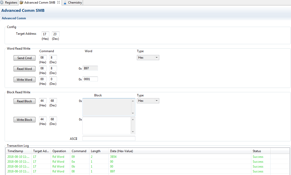

I am trying to interface BQ4050EVM-561 with STM32F7 and fetch Batt. Pack Vtg and display on STM32F7 UART.
How should I proceed in this.
The device address is 0x17 ?
And the register address of battery pack vtg is mentioned as 0x09 on
Any specific tips?

    The bq40z50 uses SMbus protocol. More information on this can be found at www.ti.com/.../slua475.pdf
    The 8-bit address is 0x16/0x17, where the lowest bit indicates if it is a read ( bit is 1) or a write(bit is 0).
    You should be able to send a read word command of 0x09 with return length of 2-bytes to get the Voltage.
    You can also try this in the "Advanced Comm SMB" tab of bqStudio while monitoring it with a bus sniffer, and duplicate the sequence in your code:
    Swami

  • Hi Ameya,
    With your STM implementation, please increase the delay between sending commands and try again.
    If the issue still persists, please confirm that you are able to communicate with the gauge using the advanced comm window in bqStudio as shown above. If this works, please use a logic analyzer to check the waveform of the known good process against the waveform generated by the custom microcontroller code.
