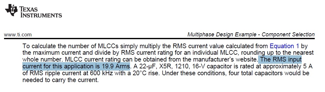

After i read the Slva882 document, i have some question. Thanks for your responsed.
Question1. I would like to know where the 19.9A comes from ? Can you provide the formula ?
Question2. How to use function "floor" ? EX: n=3phase; D=3.3V/12V=0.275; m=floor(n x D)=floor(3*0.275)= ?
    Please refer to formula 1 of slva882, condition here is 12VIN/0.9VOUT with 6phases, so the normalized Cin RMS current is 240A * 0.083 which is 19.92A.
    Floor(n x D) is the maximum integer that does not exceed the n x D, i.e. floor(3*0.275)=0
