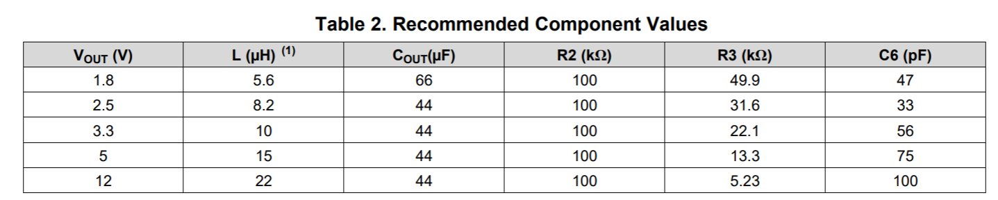

Hellow
Can I use this device below the following conditions?
Input Voltage : 14V ~ 15V
Output Voltage : 13V
Output Current : 2A
if Possible, Can you recommend circuit?
Regards.

Hi Louis,
In theory, it is feasible, but there is voltage drop on the Rdson, DCR, PCB resistor. You'd better use the inductor which has small DCR. You can refer to the datasheet and user's guide to design the schematic. And you can choose the values of inductor and output capacitor as below.
http://www.ti.com/lit/ds/symlink/tps54202.pdf
Shawn
