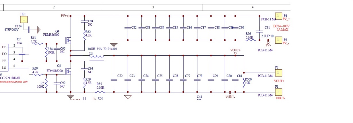

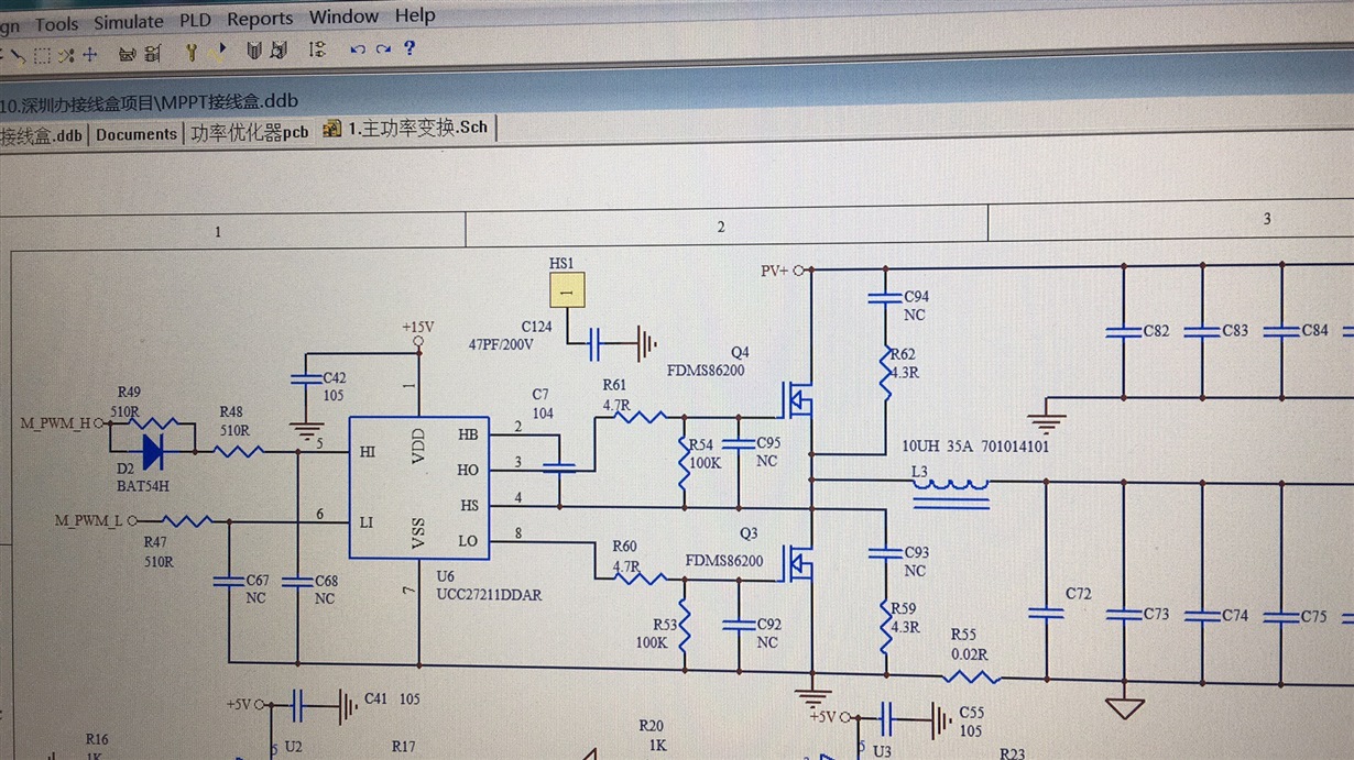

Hi Tis,
We use UCC27211 as the PWM controller for buck DC/DC,the sch is referred by  tidrck9.pdf. when HI /LI are set to 0, HS output is 10VDC. if it is correct?
the sch is as follow:
