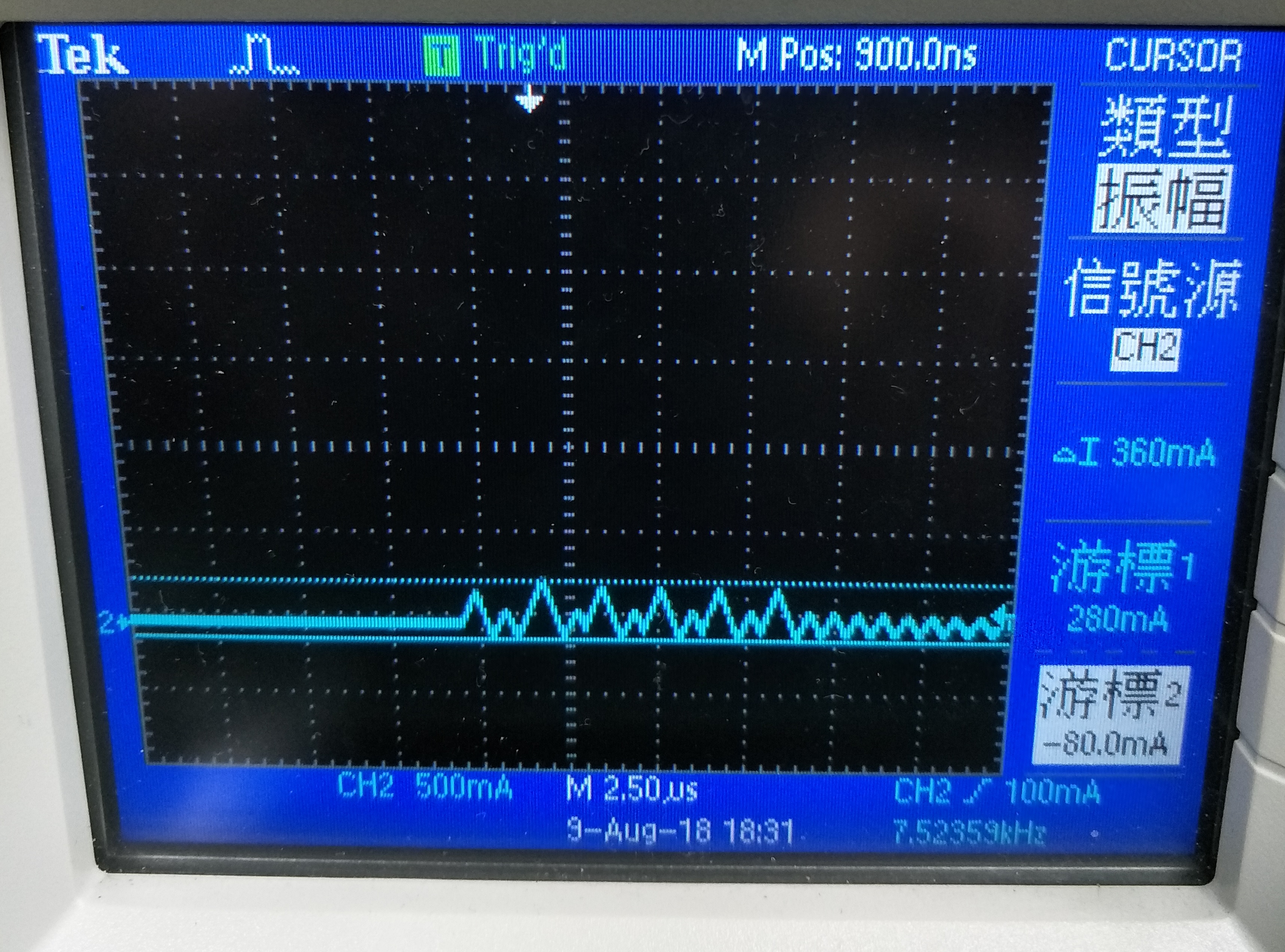

Hi

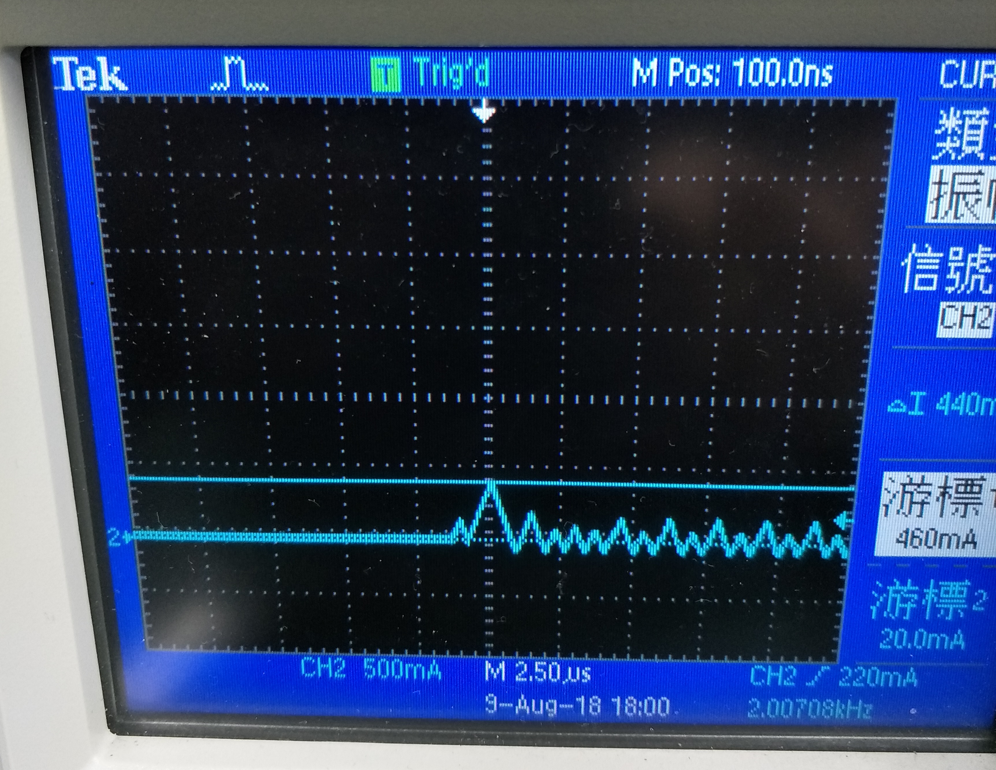

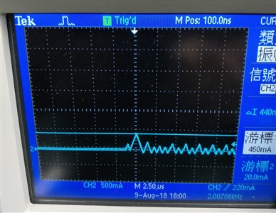

I  use TPS92692 as booster to light up 15 LEDs. I have low dimming requirement and need LED current low to 0.1mA. Hence I set IADJ voltage to 10mV and use PWM dimming. PWM duty may change from 1/50 to 50/50. I found LED may flicker from PWM 1/50 to 7/50 and I measure the inductor current as figure1. I also design TPS92602 for this low dimming application but TPS92602 doesn't have flicker issue. The inductor current as  figure2. The inductor current very different in low dimming and could TPS92692 low dimmig behavior like TPS92602?
Figure 1. TPS92692 inductor current
Figure 2. TPS92602 inductor current

    From section 8.3.9 of the specification for TPS92692: The IAJD input range is 140mV to 2.25V. So when you using 10mV input to IADJ you are not within the range that the TPS92692 required.
    Are you wanting to run 0.1mA average current on the LED with PWM? Or are you trying to run 0.1mA when PWM are ON so for 10% duty cycle the average is 0.01mA? For low current the external components have to be sized correctly also. Looking at the current on both of your scope capture they both do not look stable to me. It should be one high peak for the first pulse then all the pulses after should be the same.

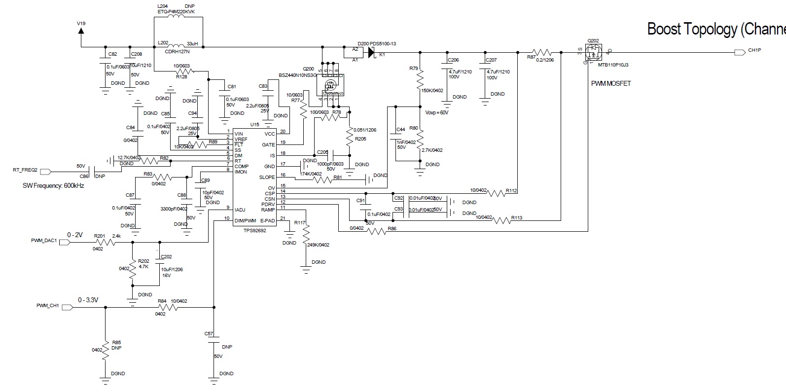

    Are you using the TPS92692 evaluation board or are you doing your own design? In the mean time can you send your current schematic that you have of the TPS92692 to me so I can review it.

    I design my own TPS92692 circuit base on EVB schematic. Below is my schematic.
  •  Hi Jason,
    Based on your schemactic, you probably have gone thru all the calculations already to use 0.2 Ohm for RCS (R87).  The key is to raise RCS as high as possible and still be able to get the peak current with IADJ at 2.25V based on the below LED Current programming from the data sheet.  The main thing we should try to do is to get as much signal with the 0.1mA as possible.  For your existing design, the current is 5mA at 1/50 duty cycle that gives 0.1mA.  With 5mA thru 0.2 Ohm you are only getting 1mV of signal.  This is too low of signal.
    The other is to use the lowest DIM/PWM frequency as possible when dimming and this will give us the most time for the loop to catch up and be stable.  What is the DIM/PWM frequency are you commanding?  You mentioned 1/50 as the duty cycle...Is this a system constraint or you can use lower duty cycle like 1/100?
    Can you also give me your requirements with input voltage (V19 from schematic), forward votlage of the LED's, max DC current you are trying to command with IADJ and what is the application for this design (end product)?

    For the 19V input voltage and 600KHz switching frequency, the RIS (R205) should change to 0.130 Ohm and RSlope (R81) should be 69.8K.  The power disipation on R205 is about 0.25W so use appropriate rating power for that.

    Change R205 to 0.13 ohm can improve low dimming flicker issue, but the MAX output current will drop to 70mA when output current bigger than 595mA. So I change R205 to 0.1 ohm then the output current can meet 750mA requirement and flicker also improve. It's seems TPS92692 also senses MOS current for internal control, not only over current protection.

    The TPS92692 has an inner peak current control loop so R205 is feeding back the peak current for part of the control loop.  The low current requirement really tests the signal to noise of the design.  By changing R205 to 0.1 Ohm you are increasing the signal by a factor of 2 for the inner loop.
