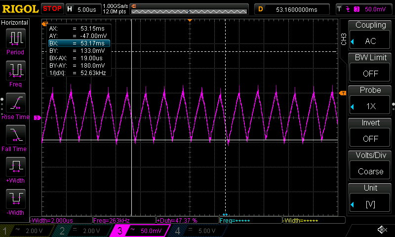

  • Sam,
    Ripple on VIN (VIN=12V; Load current=1A; Vout=5V) pin is around 100mV peak to peak (measured on ceramic capacitor "Cin" near second pin of LM3150 )
    I did measure values of Switching frequency and approximate value of Vin ripple in different values of load current and input voltage at Ron=220kOhm.
    At different values input voltage ripple waveforms did not changes, because of this I don't attached images and only wrote amplitude of ripple
    Load current = 1A:
    Vin ripple ~=100 mVp-p when Vin=6...12V; Vin ripple ~=150 mVp-p when Vin=25V;

  • Egor,
    The VIN ripple looks to be too high. And it looks very triangular so I'm thinking the ceramic cap is too small compared to the electrolytic cap. This may be affecting the switching frequency.
    Another thing I thought of could be noise injecting into Rt. Check Rt and make sure there isn't any ripple on that pin.
    Can you share the schematic and layout as well? That will give me a more complete picture of your system.

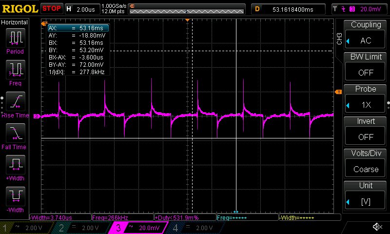

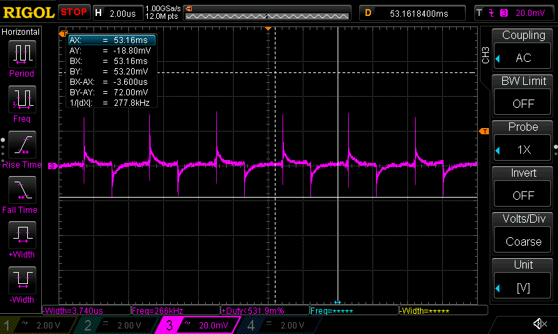

    Waveform at Ron pin
  • Egor,
    Thanks for sharing that info. I'll take a look at it tonight.
    Was your Ron measurement taken with tip-and-barrel method at the pin of the IC? That amount of noise may affect the frequency and I want to make sure this is real noise on the pin.
    -Sam
  • Sam,
    I used another method when instead of a long ground wire a short grounded coil placed at the end of the barrel of the probe.
  • Egor,
    Okay thanks for measuring that with the proper method. Thank you for all the thorough information you're giving me. It's very helpful in this debug. This is a particular problem and it's very useful to have complete and organized data.

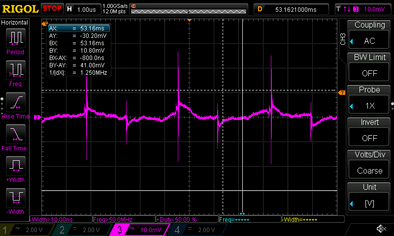

    The Ron waveform is still getting to me. This should be similar to the VIN triangular waveform but instead it looks something related to a square wave. What's the DC voltage on Ron?
    I see you have a single cap on the output with 200 mOhms ESR. This will create more ripple than is necessary for this controller to work and may confuse the feedback and cause it to trip earlier (unlikely but it's a possibility). You can try adding 1uF or 10uF ceramic in parallel with this cap.

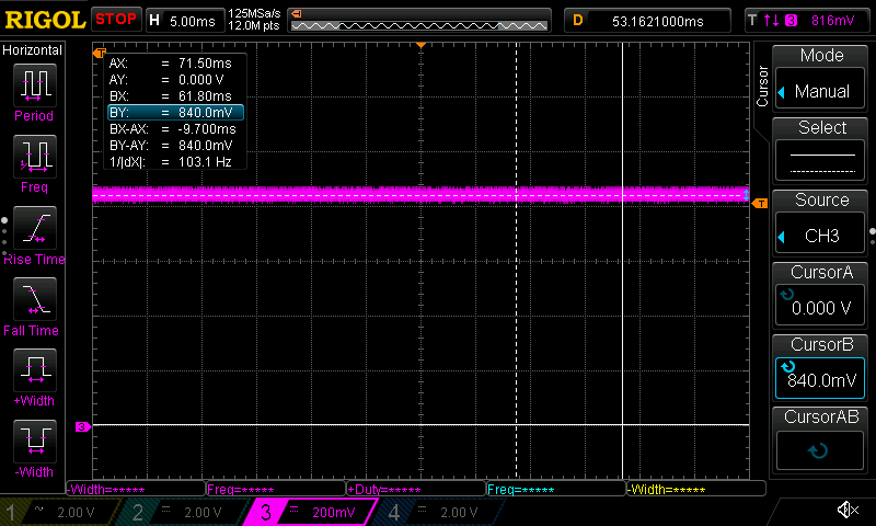

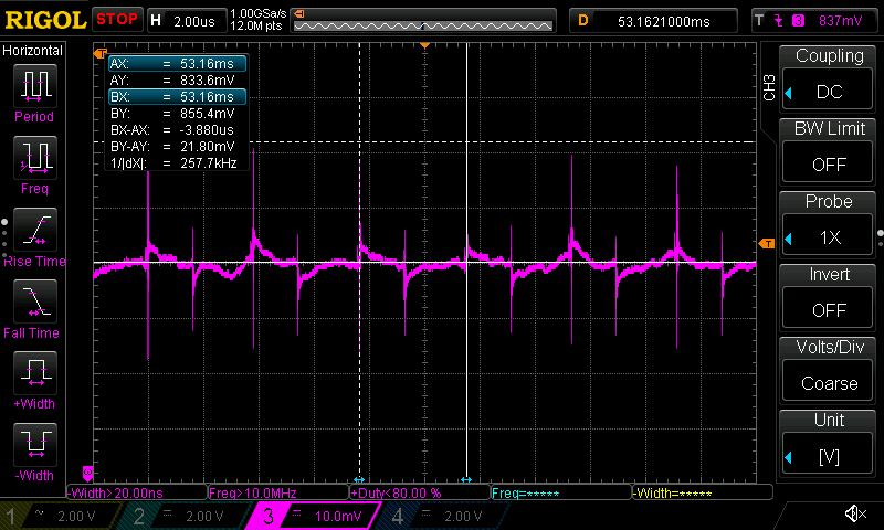

  • Sam,
    Thanks for your reply.
    There are DC waveforms of voltage on Ron pin of controller (without ceramic cap). DC voltage at Ron pin Vron=0.832...0.840 V
    I tested controller with ceramic capacitor. Adding it resolved promlem in instability at Vin>20V; Load Current = 2A; Ron=220kOhm(260kHz), but it didn't effect at switching frequency (it was still 260kHz). There is AC waveform at Ron pin with ceramic cap GRM31CR61H106MA12L (10uF) below.
