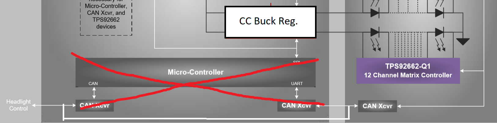

TPS92662-Q1: CAN off Main Bus? No MCU
Part Number: TPS92662-Q1
Is it possible to have the TPS92662-Q1 communicate directly off the main CAN bus in the vehicle with no MCU? Something like the picture below? My feeling is that the answer would be no since the TPS92662-Q1 since it isn't actually CAN protocol, but wanted to check.
