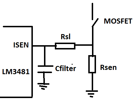

Part Number: LM3481
To find current sense resistance which formula should be used.
a) Rsen = Vsen/Ipeak
b) Rsen = (Vsen - Vsl -Rsl*k) / Ipeak
vsl = 90mV, Rsl=1k, k=40uA
Part Number: LM3481
Hi Garrett,
Does the formula remain same to find short circuit current limits too ??
