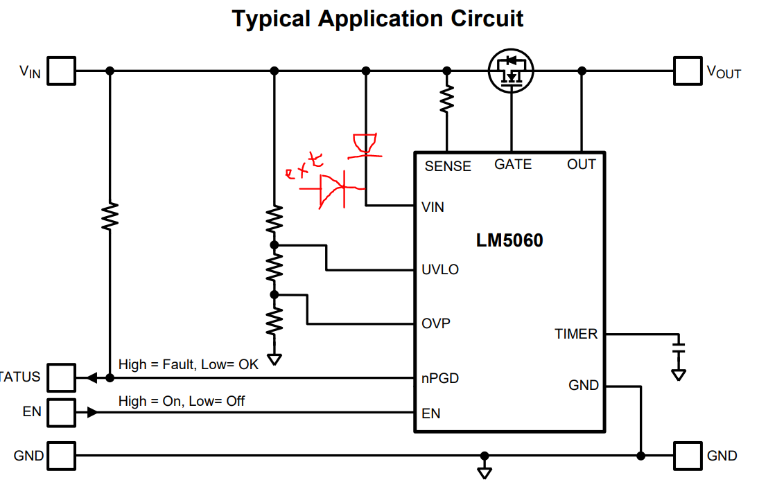

Is there a way to diode OR in a 5.5V power supply to either VIN and/or SENSE so that the chip sees its minimum input voltage but then operate down to 3.5V at the drain of the NFET?
