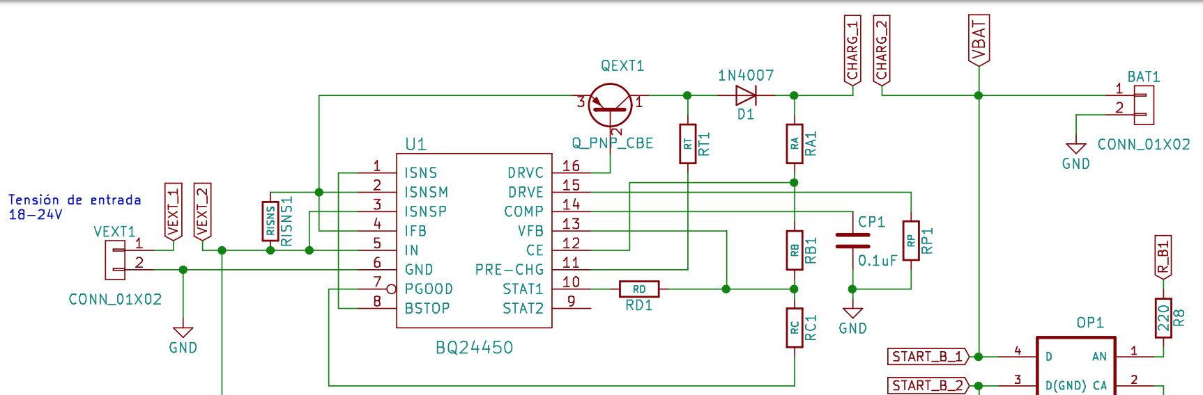

BQ24450: Charge current too high
Part Number: BQ24450
I have created a design following the pre-charger circuit in the data sheet but when I power Vin the current overshoots the expected max value by over 3 times.
The battery is a 12V 5Ah SLA and the system has been calculated for 1A charging current, so the Rsense is 0.25 ohm.
The voltage seems to be regulating well so it would seem that the current limiting loop is not working properly. As soon as I plug it in the current jumps to 3.5A and stays there (at least for a few seconds until I unplug it).
I suspect the part might be faulty, but if there are any other ideas, I'm happy to try them.
Thanks.
