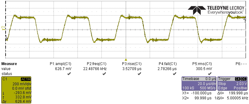

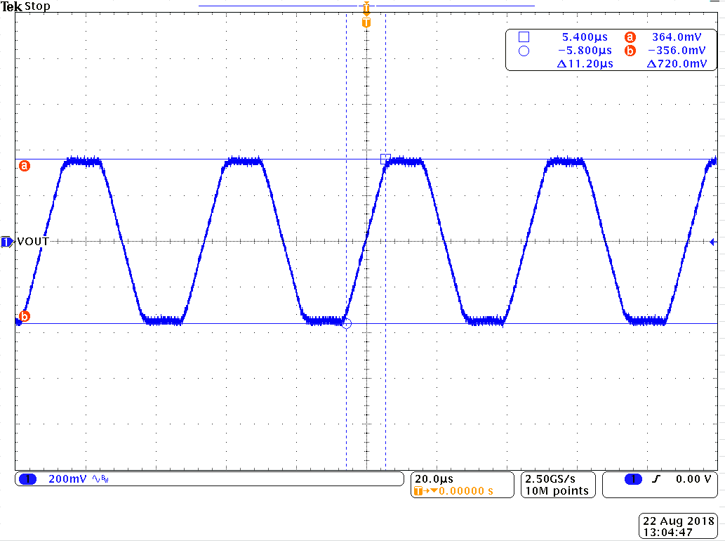

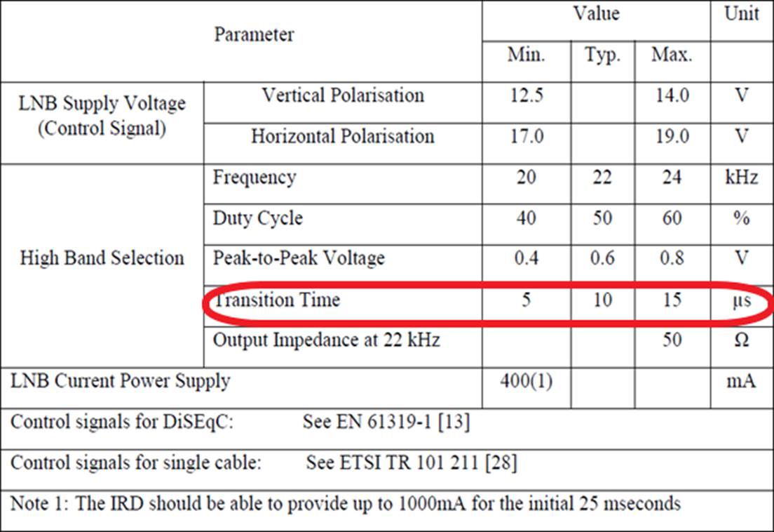

Based on the chip required, the minimum rise and fall time of 22-KHz is 5us. Customer test our TPS65235 which cannot meet this requirement.
Can we modify rise/fall time of 22-KHz signal? Please let me know if you have any idea.
