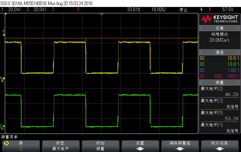

my customer is using UCC27200A in their DC/DC push pull circuit. The DC BUS is 48V from battery. There are several times that they find the device HB and VDD shorted, which means that the diode is broken. The break happens during the start up of the push pull circuit.

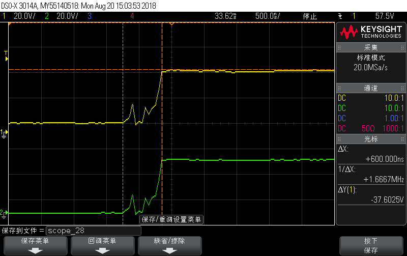

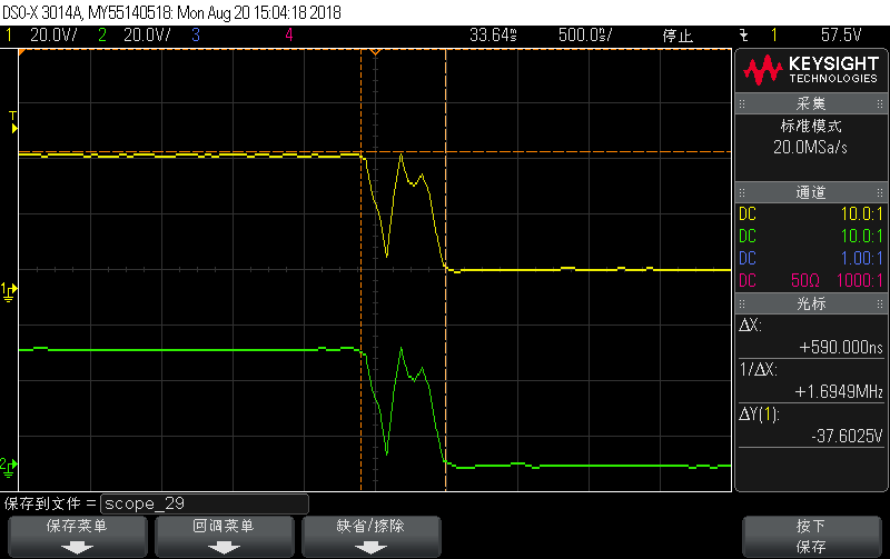

we measured the voltage waveform with good device at operating, CH1 HB to GND, CH2 HS to GND.
rising edge
falling edge

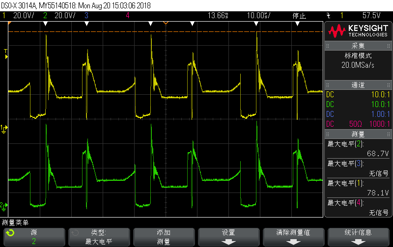

During the circuit start up, the voltage waveform is as below: the peak voltage can reach 78V. But it should still be within the recommended operating condition.
1. what's the breakthrough voltage of the internal diode?
2. what may cause the shortage between HB and VDD, how to solve it?
