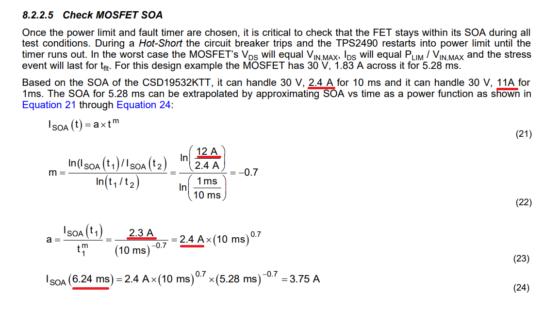

TPS2491: TPS2491 Datasheet calculation
Part Number: TPS2491
The following calculation have some values which do not match the exemple. For some values, it is clear to see where the mistake came from. But, for the 6.24ms, I do not have the answer. It just that those value can be corrected with the next revision.
