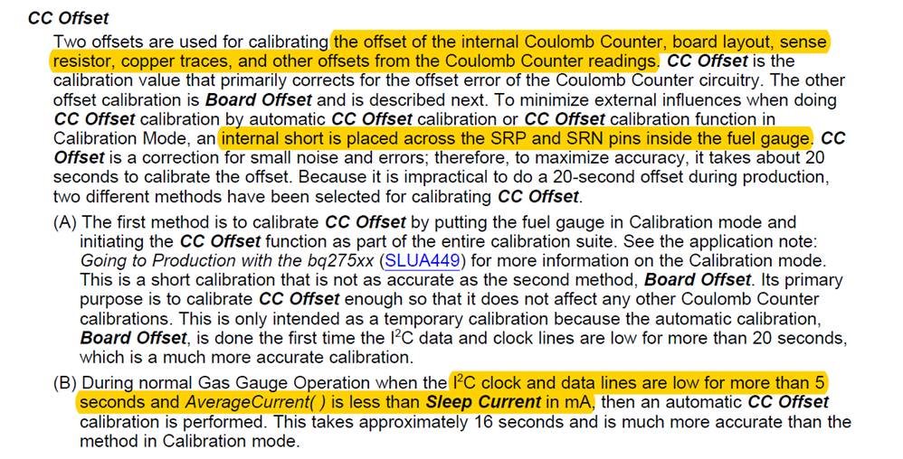

I  found a phenomenon that ‘CC offset ’ register of BQ27510-G3 will change automatically. For example, I update a golden image to BQ27510, the ‘CC offset’ is set to 1320 mA. But after I read the ‘dataflash’ register several times or I re-turn on the board, ‘CC offset ’ changes to 1482 mA. My operation is under normal mode.
I notice there is a description as below. So I want to check whether this phenomenon is normal? If yes, whether the situation B is triggered? If no, what should I do to fix this?
Many thanks.
