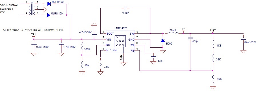

Respected Sir,
I have used LMR14020 in one of my design. You can see it below-
PROBLEM: Normally, the PCBs are working fine but sometimes it gives 20V(OP) instead of 15V. Again I restart the Power supply again it is working fine.Randomly, Sometimes it is giving 20V at PP1.
 I have checked EN voltage it was showing 1.9V which is enough to turn on my switcher.
At Pin 5 I got around 0.8V it was also correct. I don't understand why it locked at 20V(OP) sometimes during the power-on event.
