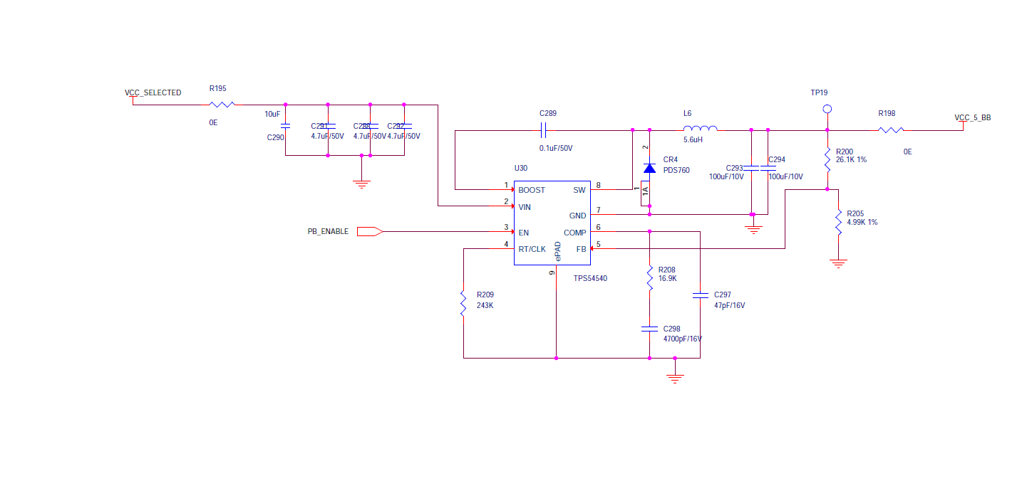

TPS54540: Issue with TPS54540 to support a load current of 1 amp.
Part Number: TPS54540
I am using TPS54540DDA in my design. I am giving an input of 12 V (VCC_SELECTED)  and  taking an output of 5 V (VCC_5_BB).
But under load condition TPS54540 is not able to support more than 0.5 A current. When i am bypassing TPS54540 and supplying 5V
directly from power supply ,my board is working fine. Here load current drawn is 0.8A.
I have attached the schematic file of this part.
Kindly help me on this.....
