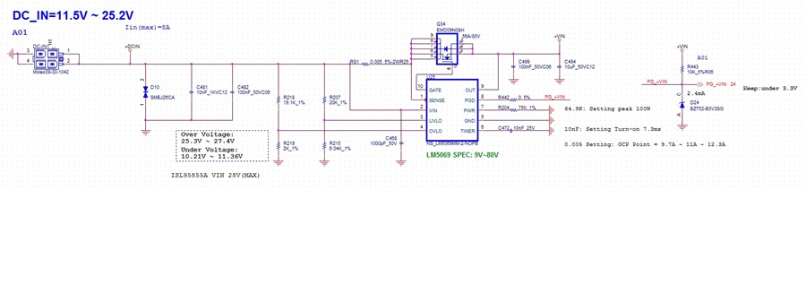

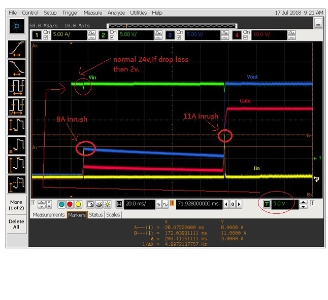

i have a question,please refer the schematic and waveform below. we used  LM5069MMX-2 on the IPC power source side.
why the inrush current in the 8A dose not turn-on the MOSFET, instead,the inrush current turn-on MOSFET at 11A..why , i setting the OCP point  range to 9.7A~12.3A.
can you help to see the values of discrete components have set errors?
