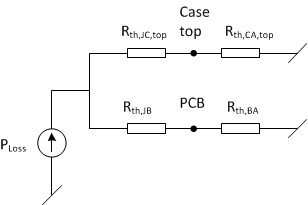

  • Hello Masoud
    Thanks for the offer - I happily accept it.
    The print I have has two LMG5200 mounted on top side (H-Bridge configuration).
    Both modules are thermally well connected (lots of vias)  to a cooling area on the bottom layer (40 um thick)  of the print. The whole area is ca. 22 x 46 mm.
    The print is vertically mounted, no forced cooling.
    What I would be interested is a thermal resistance equivalent circuit, and the corresponding values. I tried the circuit as in the attached .png. It considers basically two paths of thermal flow: One via top side through the case of the module, and the second path through the vias to the bottom side via the PCB cooling area.
    The left thermal resistors in the equivalent circuit are the ones given in the datasheet, the right two are unknown to me.
    Is the thermal equivalent circuit ok?
    If yes, what values should I take (or what total Rth junction - ambient)?
    If you propose an other thermal equivalent circuit: Could you send me a drawing and the corresponding values?
    Thanks a lot
    Beat
  • Hello Beat,
    Most of the heat will be dissipated through the bottom of the IC through the vias and into the copper plane(s) in the PCB. Since there is no forced air cooling the contribution through the top of the package should be negligible.
    I assume you have already gone this app note as well: www.ti.com/.../spra953c.pdf
    Hope that helps.
    Thanks.

  • Hi Beat,
    Some suggestions for your consideration. The circuit thermal path looks okay with us; however, we don’t have the Rth_CA number. Indeed, the top path can be considered negligible since most heat will be dissipated through bottom. Rth_BA depends on your specific layout (copper plane size/thickness, via dimension/number). We don’t typically measure the Rth_BA. One possible way to leverage TI’s thermal calculator would be picking up a similar QFN part (thermal pads size) which is already in the library and refine/import your PCB design for calculation. You can then get the thermal resistance accordingly. This can give you a ballpark number for design analysis. As LMG5200 uses a unique package, we don’t have a good recommendation so far, but we are working on adding it into the library. Definitely the most accurate way would be to measure it directly.

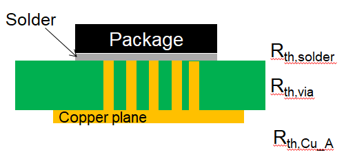

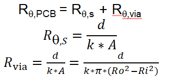

  • Hi Beat,
    Apologize for the delay. To help you better understand, please refer the drawing and equations as below. For your case, the Rth_PCB can be calculated which includes Rth, solder, Rth,via. But the copper plane to ambient Rth,Cu_A can't be calculated. You have to rely on the thermal simulation software, or by measurement.  Besides, you may want to consider the heat spreading. See the reference paper for explanation. I attached the equation for Rth, solder and Rth,via for your possible reference. Hope this helps.
     Ref on heat spreader:
    M.M. Yovanovich, Y.S. Muzychka and J.R. Culham, "Spreading Resistance of Isoflux Rectangles and Strips on Compound Flux Channels," AIAA 98-0873, presented at the AIAA 36th Aerospace Sciences Meeting and Exhibit, Reno, NV, January 12 - 15, 1998.
    Rui
