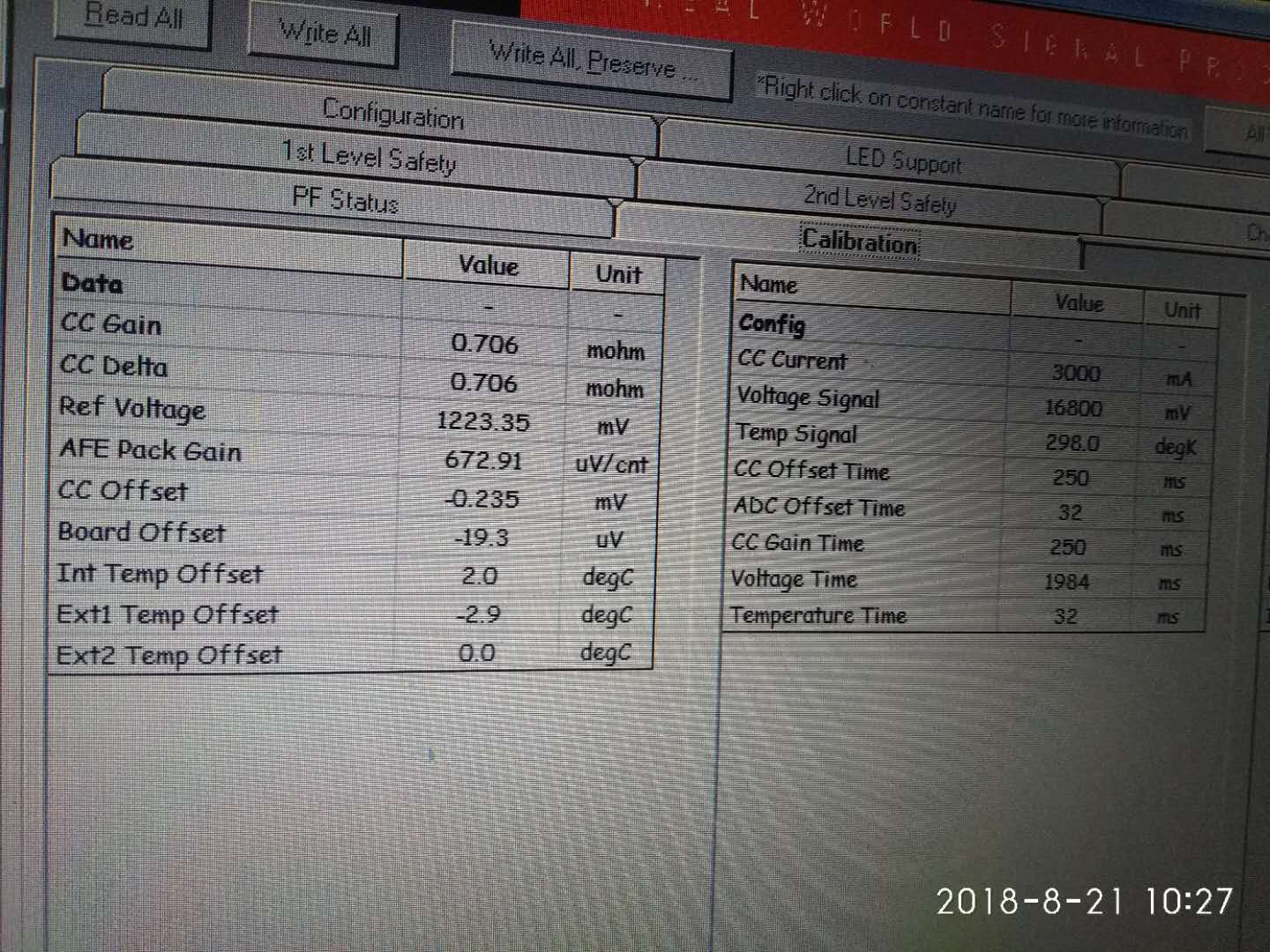

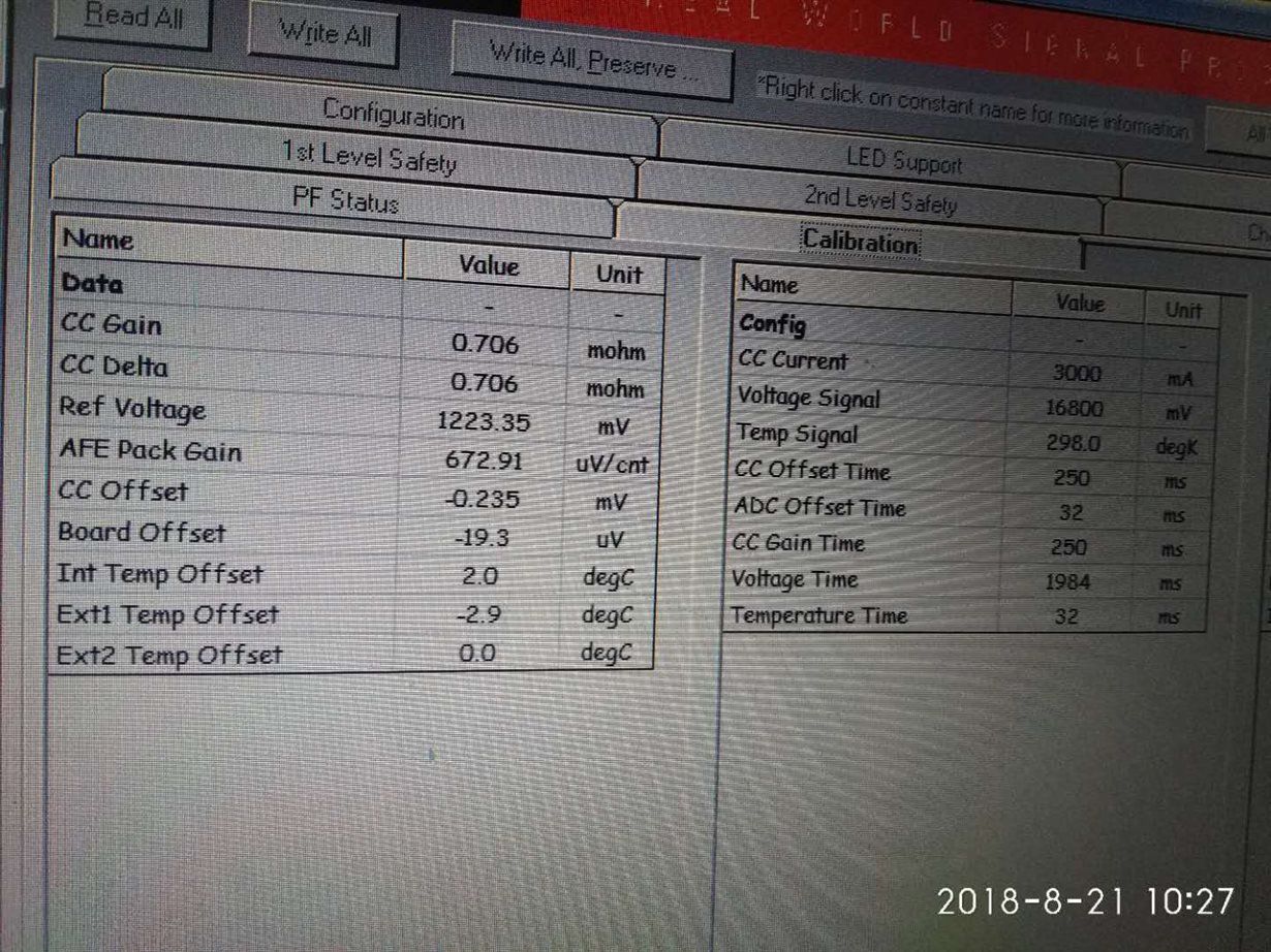

BQ20Z95: BQ20Z95 issue
Part Number: BQ20Z95
my project:Lithium battery pack fuel gauge
I used BQ20Z95 to process it.
This product has been mass-produced and the product has encountered problems.
1)The calibration coefficient of bq20z95 is automatically changed,resulting in inaccurate current measurement and large current. The CC Gain = 0.706,CC Delta = 0.706,The values of these instructions are wrong. What causes the calibration coefficient to change?
2)You can refer to the attached configuration parameters and calibration coefficient picture.
Thanks.

[Data(Calibration)]
CC Gain = 2.026
CC Delta = 2.026
Ref Voltage = 1223.00
AFE Pack Gain = 672.91
CC Offset = -0.296
Board Offset = -10
Int Temp Offset = 2.0
Ext1 Temp Offset = -2.9
Ext2 Temp Offset = 0.0
[Config(Calibration)]
CC Current = 3000
Voltage Signal = 16800
Temp Signal = 298.0
CC Offset Time = 250
ADC Offset Time = 32
CC Gain Time = 250
Voltage Time = 1984
Temperature Time = 32
Cal Mode Timeout = 300
