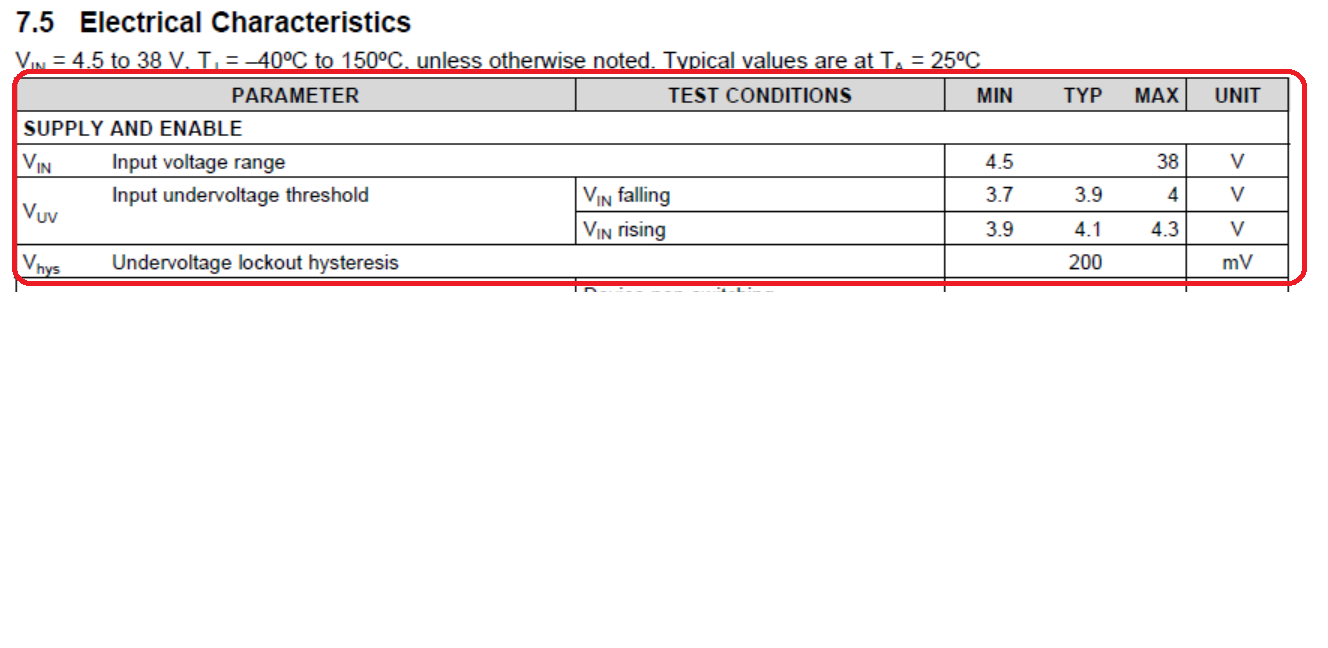

    Thank you for the assessment and recommendation. I used LM5122 in one of our previous design. It has the similar requirement of supplying a voltage of 4.5V plus when the main Vin can be as low as 3V. This will add complexity to the circuit. But if it is the cost to get a higher overall efficiency of >90%, I will do it. Is there any white paper describing the reason behind that a voltage of 5V needed? Or it is a general rule that from Vin=3V to Vout=24V, it is too high for one boost converter to handle when the output current is at less than 1A range?

  • Hi Jin,
    Need an extra 5V is because TPS43061 has minimum startup voltage requirement and UVL requirement. Please check the below table:
